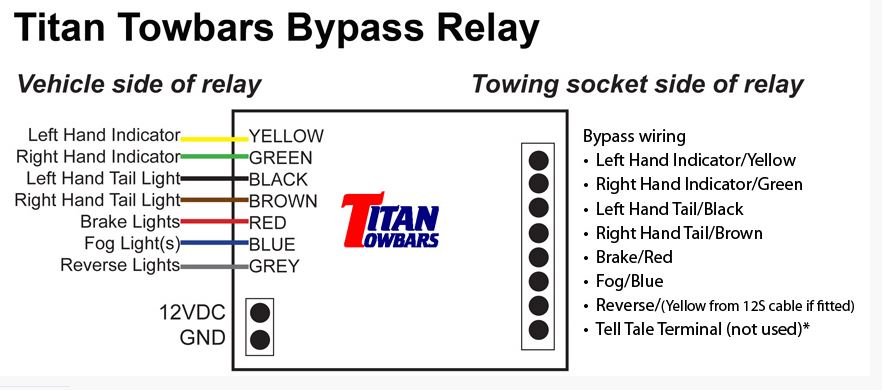

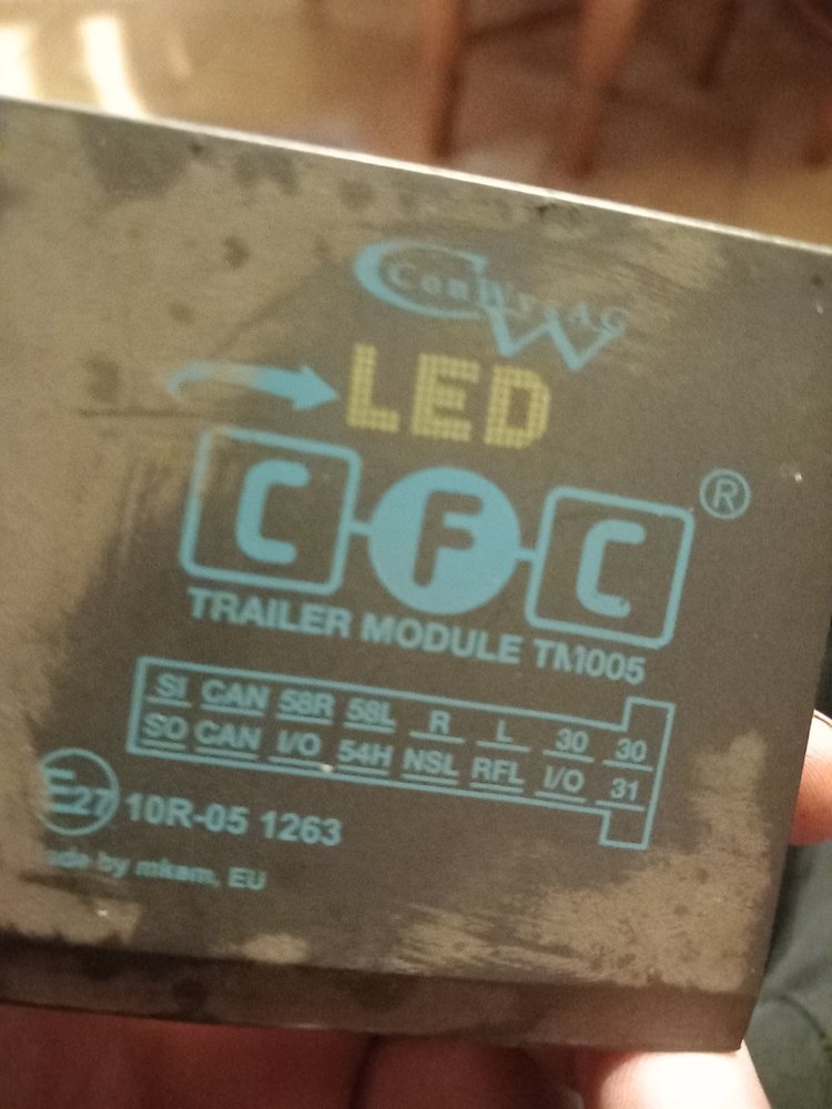

Mates got a 2018 berlingo van
Trailer socket stopped working
Tested a few bits and got power going into this little module but none coming out
Looks to be a few hundred quid for a new module
Now my question is...
Can i wire the lights in without it and will they work?
Aware that the trailer indicators light on the dash probably wont work but not to worried about this
No parking sensors fitted on the van so haven't got to worry about them being turned off when a trailers attached
Im thinking there'll be something in the brain of this module that the lights wont work without or is it just for the parking sensors and dash indicator light?
Cheers
