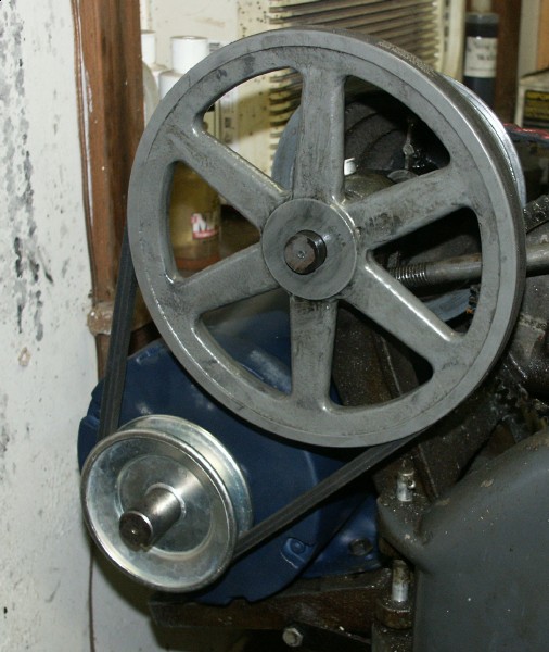

So, the motor on my lathe is shot. Probably 1940's vintage. It shakes like crazy. As the motor hangs off the back, I bet the shaft got hit during transport and bent. Looking closer, it has cloth-covered wires that would need to be replaced and probably could use new bearings.
So, off to ebay to look for a replacement. Either the motors are beat up, wrong speed, shipping is obscene or everybody and their brother has a lathe/drill/saw that needs the same size motor and the price is way more than it is worth.
However, there are dozens of 3-phase motors, brand new with no bids.
So, I decided to look at VFD controllers. Dozens of 460V 3-Phase in/out, dead/untested ones and units missing parts.
I stumbled on a unused, Toshiba 110V single-phase in to 208V 3-phase VFD. Only 1/2 HP so not a big interest (seems everyone wants 2HP and up.) Did last second bid and picked it up for $27.
Will do 0.5 to 200Hz and has LED display/keypad:
Next, bid on brand-new, 1HP 3-phase, 1100RPM motor. Only bidder,and pick up for $25 + $14 shipping. So, motor + VFD, both new all for less than $100. A decent BB motor would have cost me that.
Got the motor yesterday, and fitied it on the lathe:
Hopefully, the VFD will come today. It does not have a reversing switch on the panel and I don't want it on the lathe. So I will make a remote control panel with start/stop and direction controls.
Will post progress as I go along.
