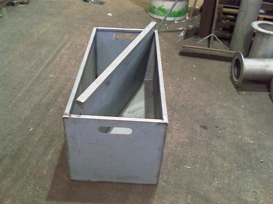

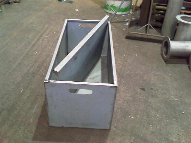

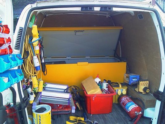

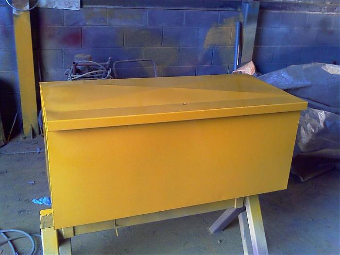

Decided to make a made to meausure van vault type box it go in my van.
Slightly lighter than proper van vaults, 1.5 instead of 2mm to keep weight down a bit.
Made from zintec sheet, folded up, ends welded on, top folded up, diamonded for a bit of extra strength.
Mortice lock, gas struts...
