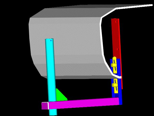

Need to make a flag pole bracket, to fit on the back of a new shape VWCaddy
Needs to be very easily detachable, yet secure enough to drive with it mounted
Initial idea was something that screwed into towing eye, but left hand square threads put that idea out of the window.
Now i have come up with a plate that picks up on the tow eye bracket mounting bolts. Then 2 antiluce clips, holding 3mm folded channels and the tube on.
I think it will be easy enough to clip on an off. Anyone got any better ideas?
Flag is about 1.8m high, but only 400mm wide, on a 19mm ally pole. I will need to make an extnsion between the bracket and flag. So total height would be about 4m from the bracket. The extension 2-2.5m long, but needs to fit into the van easily, length is about 1.6m,
Anyone got any thoughts on this?

Only thing is, with four metres of flag pole and a bit of wind there's going to be a fair old moment on the bracket whichever way you slice it....
