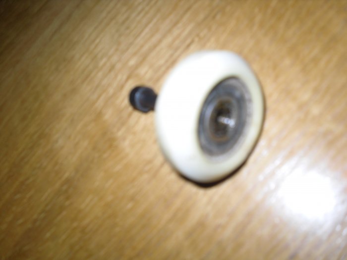

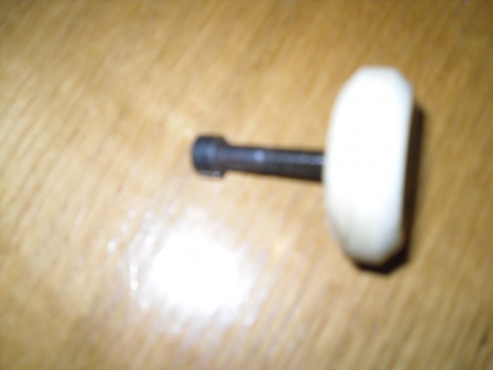

Hi All ,
I am after a supplier of some bearings,they run in a v groove [90deg] the bearings are 10mm bore 26mm od and as far as I can tell 8mm thick and are metal shielded, they have a plastic "tyre" that is bevelled on both edges at 45 deg taking the od to 40 mm, they are also fitted with an eccentric pivot that is bored and tapped m6 to allow for adjustment .Does anyone know what these are called and where can I get them, the markings on the shields are 802000 and USSR + some Cyrillic letters, they are used in a slot morticer table as the elements of a linear slide,
cheers for reading
Chris
