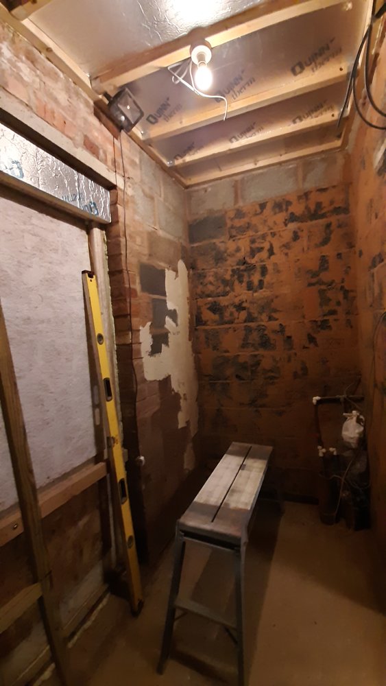

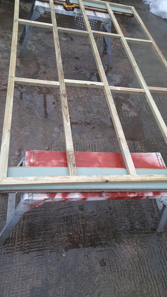

The room is part cavity part solid build and has a flat roof originally a entrance at the back of the house.

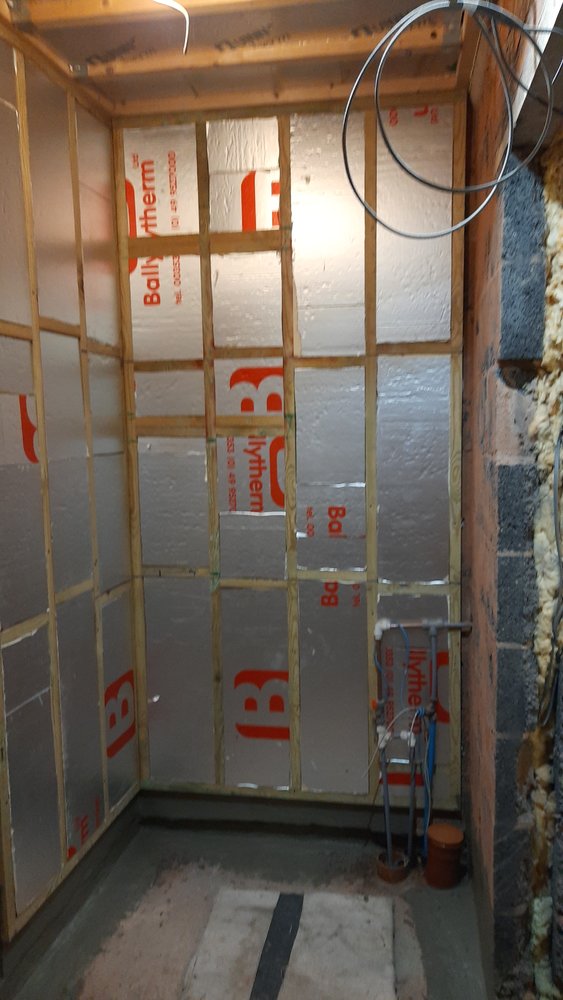

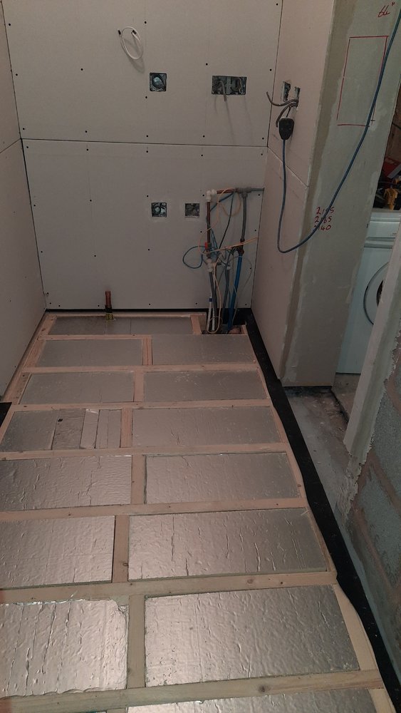

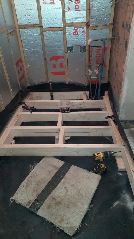

The bad old plaster was removed and made as level as possible then some lath frames made up and fixed in place trying to get them level and flat with packers and glue.

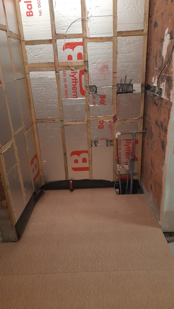

25mm insulation was fitted and a fair amount of slurry added

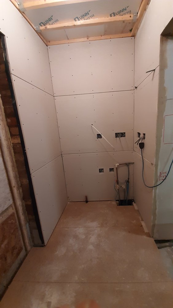

and it's almost finished
