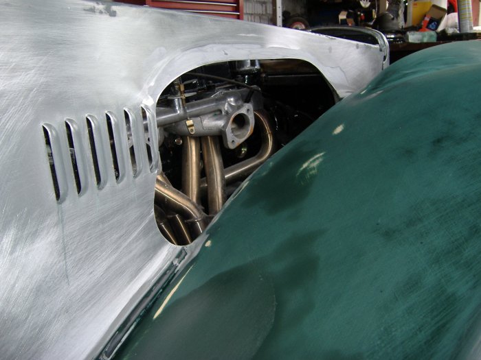

Hi Guys, need some advice please. I'm rebuilding an old Kit car It's nothing special just a hobby which I enjoy as and when time and a limited budget allow.
Most of the mechanical side of things are now sorted but a modified engine and some larger carbs have meant that I have had to form an aperture in the side panel / wing to enable me to fit the carbs and pancake air filters.
I now need to sort out the paintwork and have taken the opportunity to address some problems with the original finish at the same time (dash/ scuttle was two different colours).

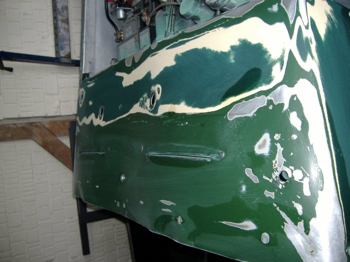

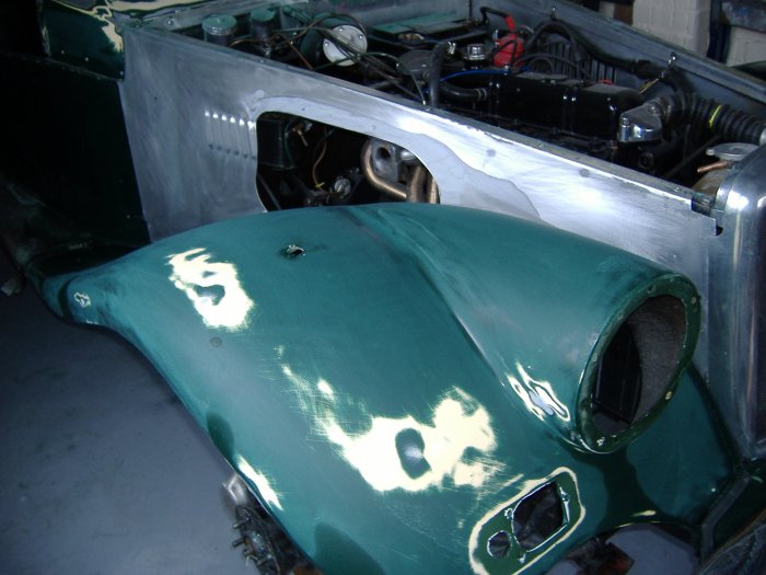

The wings are fibreglass the remaining panels are aluminium, the car is painted with cellulose paint and it has definitely been resprayed once before. I have started to prep the areas needing attention and have so far done my initial metal shaping, filling and have sanded the whole lot down with 180 grade wet and dry.
I now have a multitude of different surfaces these being bare aluminium, original primer, original colour, what I think is hi build primer and the resprayed top coat.
This is where I am stuck, I need to refinish in cellulose I do not have the equipment or skills required to use 2 Pack so have formulated the following game plan following information that I have read on this forum.

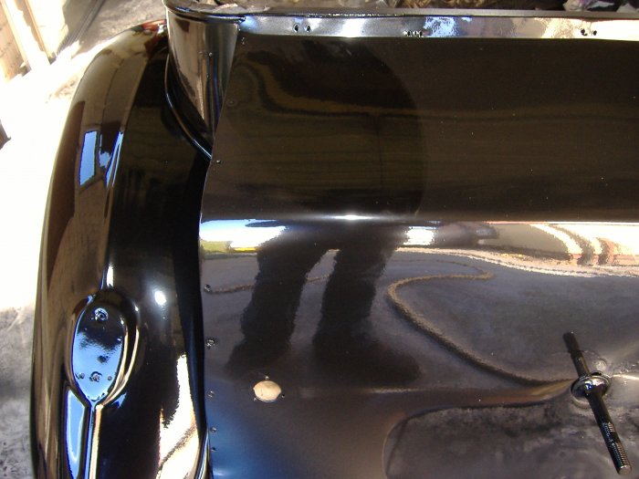

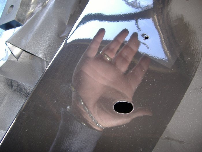

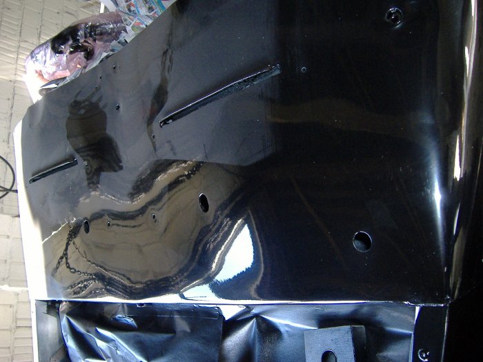

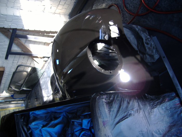

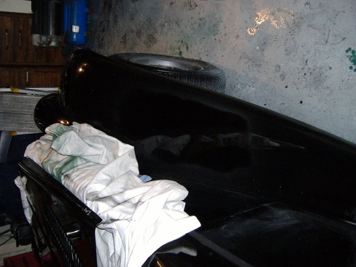

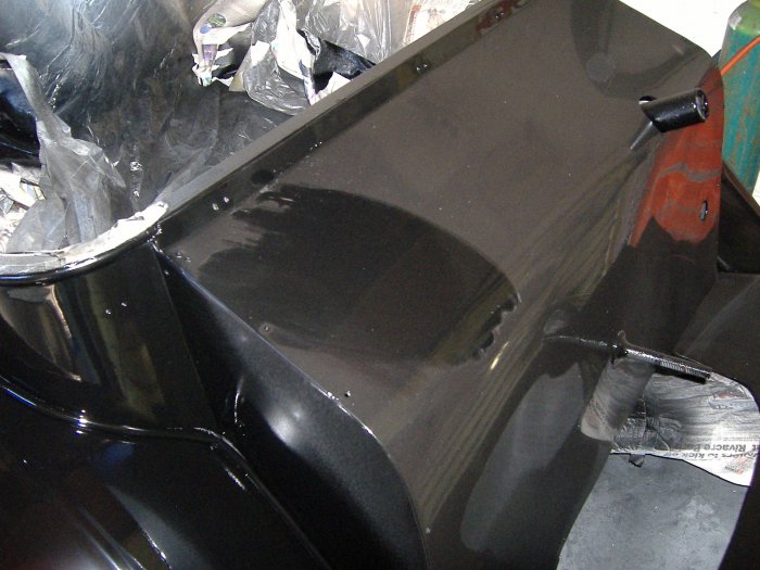

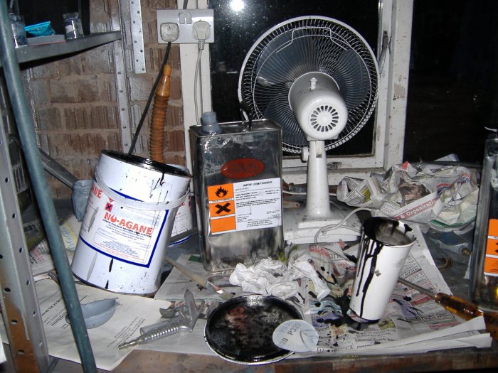

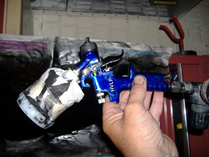

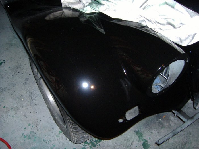

. not the easiest of jobs in a single garage, where dust control comprised of wetting the floor down and extraction was a desktop fan borrowed from work
but its all about learning and the worse case scenario is I will have to rub these areas down and redo them, I have flooded them with paint and am hopeful that given a few weeks for the paint to harden I can flatten them and buff but time will tell. All told quite enjoyed myself, certainly kept fit running to refill the small gun pot every minute or so
cellulose was chosen as it seems to be the safest for the amateur to work with but I probably negated this somewhat with large amount of cigarettes consumed between coats to try and stop my hands shaking
