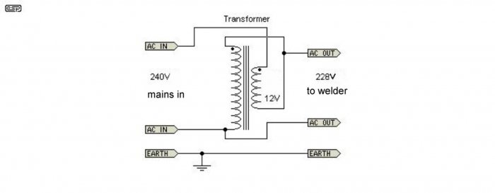

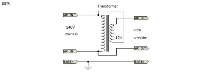

Have posted this elsewhere on here but thought it might be of some use to other people who maybe struggling with their mains voltage either too high or low The transformer I use is approx 4" square and was from a medium sized battery charger I don't know the va rating though the secondary is approx 2.85 x 3.3 mm section copper so easilly copes with the current to the welder.
