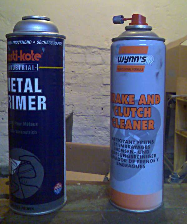

If you ever see Wynn's "Brake and Clutch Cleaner" - buy a tin, it's really handy.
The MSDS which is from their website reveals it's just acetone, ethanol and other stuff in a spray can.
It does help in cleaning off oil from brake shoes, but it's handy as a spot de-greaser and, probably best of all, it's brilliant at unclogging spray paint nozzles !
The picture shows: Left: crappy can of spray paint wot clogged up. Right: To the rescue, Wynn's Spray Stuff which happens to have a thin nozzle which fits into the bottom of spray paint nozzles... quick spray and all's well.
Also get's your hands clean of spray paint (yeh, I know it'll take all the oils out of your skin and kill you in no time)
Yours,
