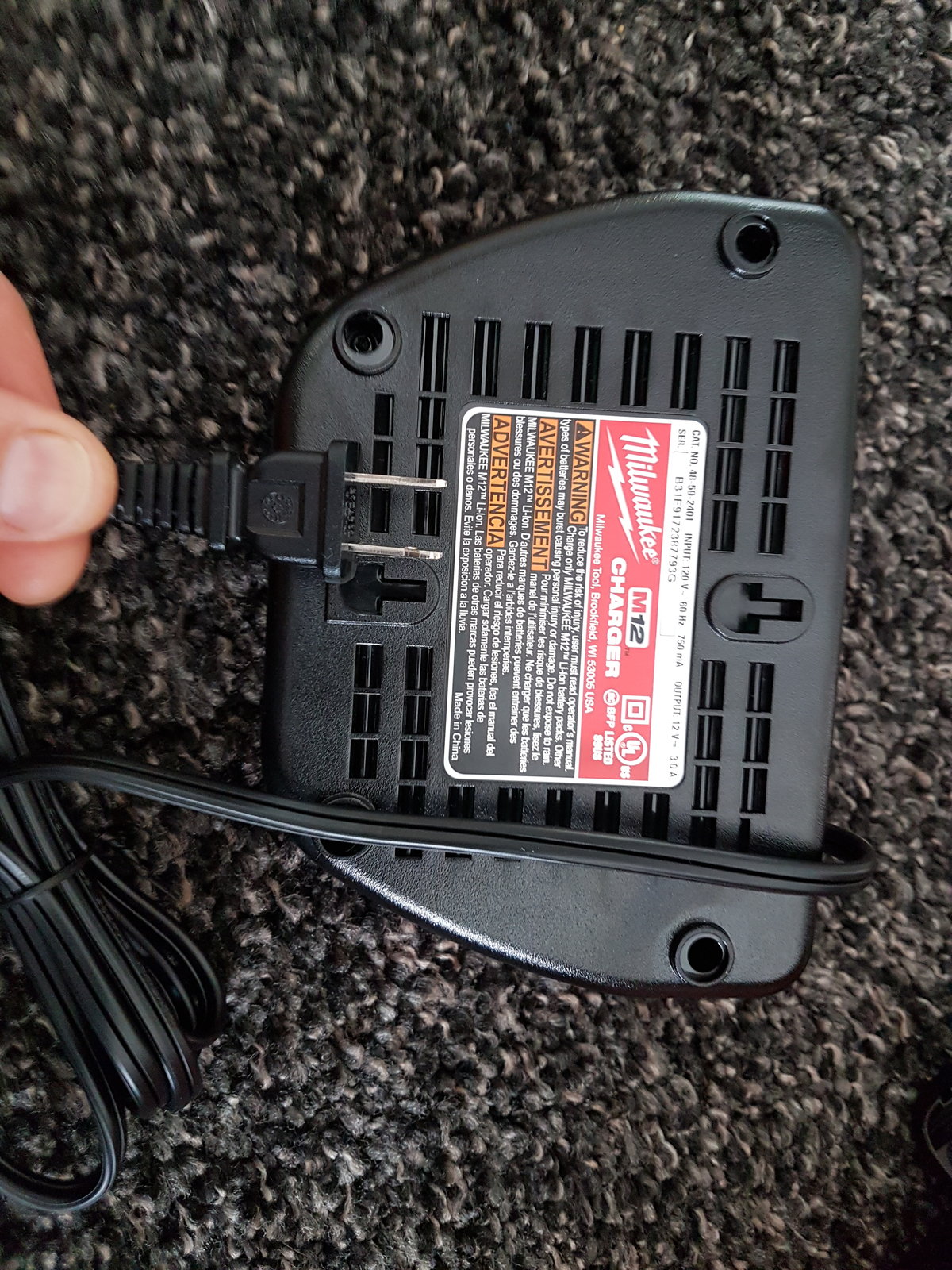

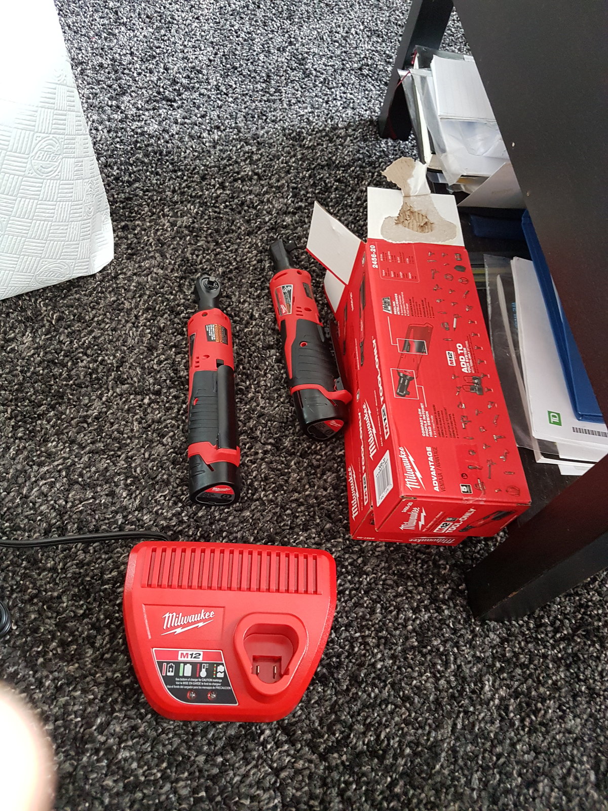

Can i just cut the plug off and change it for a UK one. I know they run 110V over there.
It is only a battery chargerYou can change for a UK 110V (yellow) plug.

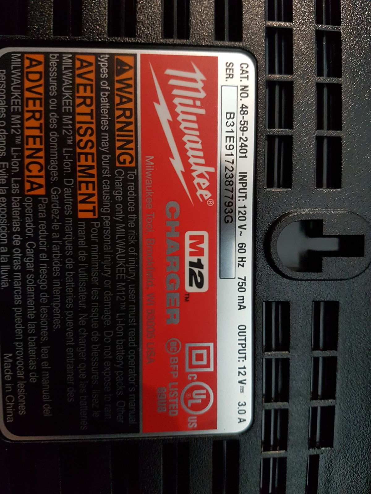

I have one already this one came with my new toysCharger is 120V input, will take 110 also but not 240. At worst buy a uk charger off ebay...something like £20ish
Almost definitely if it is transformer based I would say, because it would be supplying the electronics with twice the required voltageNo damage would occur would it
So it may work thenNo...
3/4 of an AMP
80 or 90 Watts
watt = amp × volt
so 120 volts x 0.75amps = 90watts
You can if you want but please have someone video-ing it so we can all have a laugh when it goes pop.Ok I won't plug it in lol
