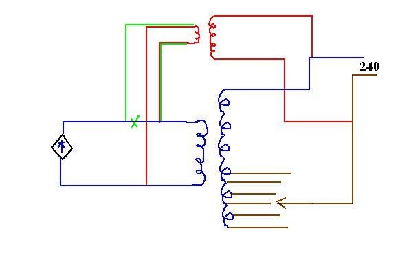

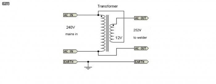

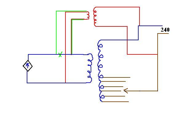

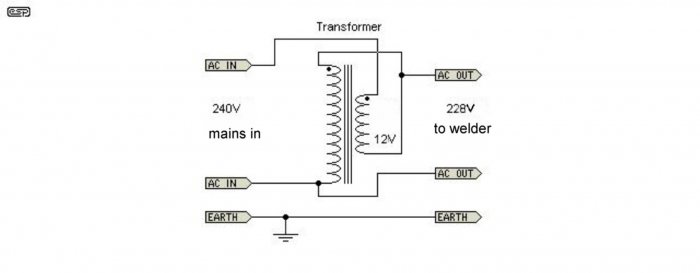

The tranny does not need to be massive because the secondry winding core being only a few turns can be easilly capable of passing the current ,and the induced voltage is only 12v which is added or subtracted, the tranny I use is roughly 4" square out of a medium sized boost charger approx 30amp ish, that was going to the scrap (as I love trannies, hum! got to be very careful who you say that to!Ah when you said "battery charger" I had in my head the shoe box size so could not get my head round it! Yes I understand that the large (wheel along) booster/starter type do have large trans in them. Use to work on USA kit that had "buck and boost" trans in (very jaring term). On a similar subject keep meaning to try the large 240 to 110 (yellow box) tran on a welder to see what sort of drop/work it might do if at all (internal 240 to 30 wirefeed tran would req bypass) As there are many with welders that don't go low enough for car body work >50amp. Would only suite lower power settings, restriction being rating of yellow box. May try if I get 5 mins...![]()
