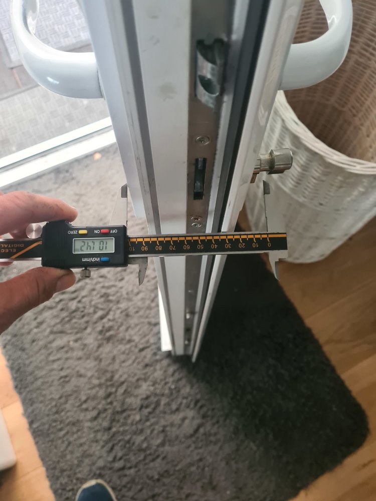

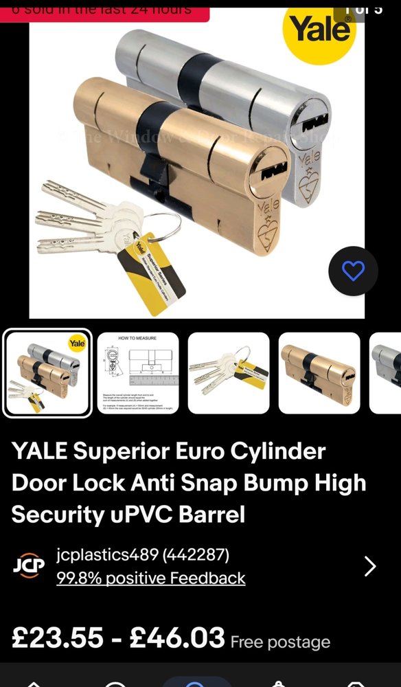

Ive noticed this. So is the 10mm latch just a given on ones with 2 numbers, is a 30 10 30 the same as a 30 30, or is a 30 10 30 a 35 35, they just don't mention 10mm of that is the latch?some manufacturers measure differently and give you 3 numbers for a cylinder.
They give 10mm as the middle number............the width of the locking/turning bit.
Makes it confusing.
I'm just changing house cylinders and have gone for thumb turn inside and keyed alike + garage/shed
thumb turns realy help them as if your out they break in (through window etc )
once in they can open the door to remove your tv as they dont have to get out the widow they come in so easyer to get out
30 10 30 is same as 35 35Ive noticed this. So is the 10mm latch just a given on ones with 2 numbers, is a 30 10 30 the same as a 30 30, or is a 30 10 30 a 35 35, they just don't mention 10mm of that is the latch?

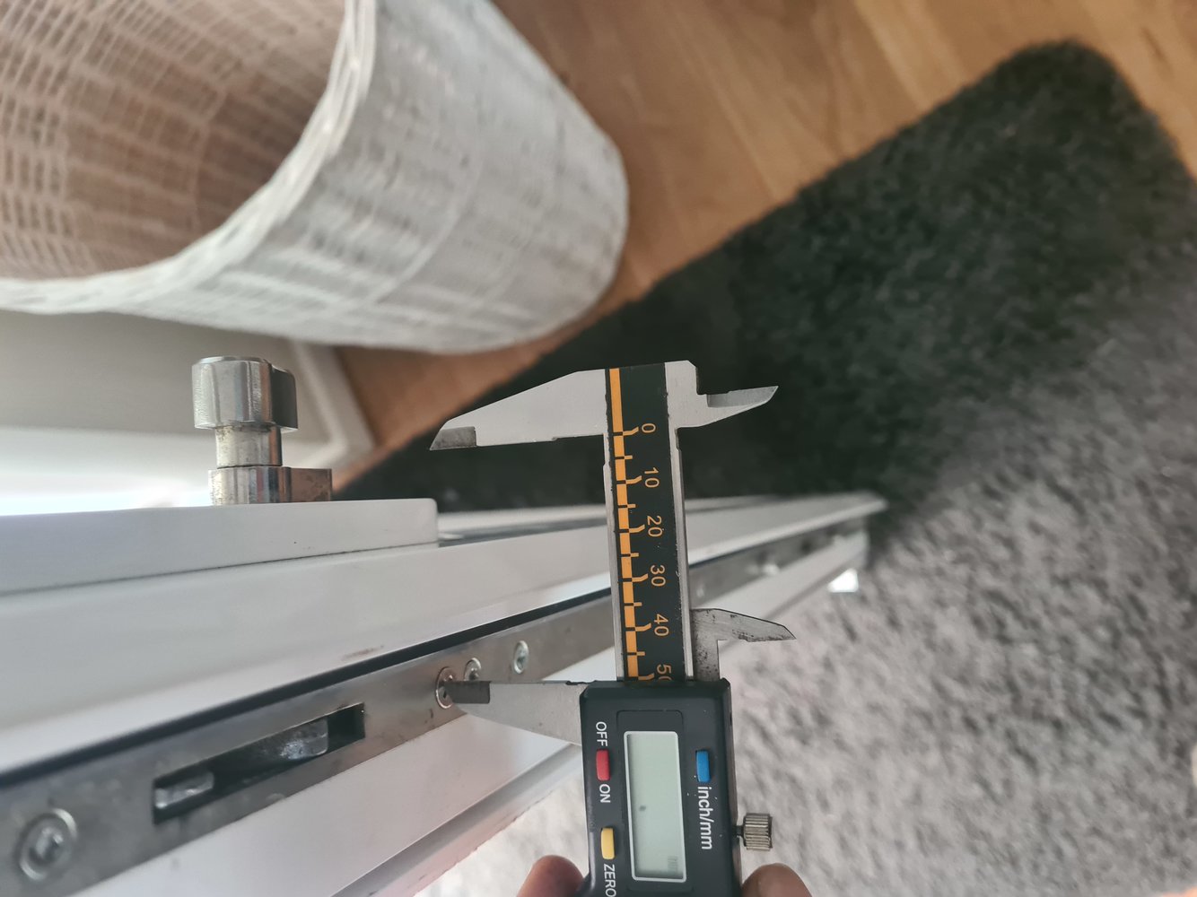

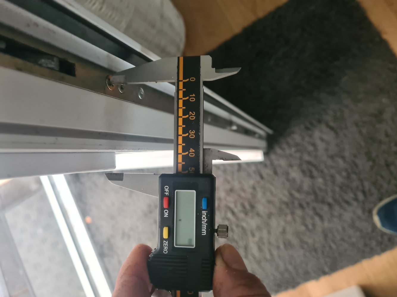

I've fallen foul of thatJust make sure you measure from the centre of the securing screw hole in the body, to either end of the lock, some are asymmetrical….
