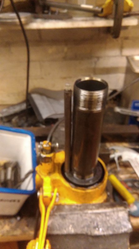

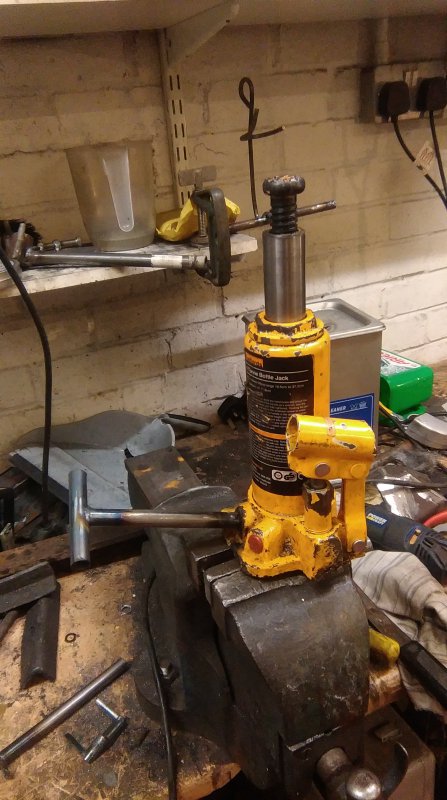

Very simple but it works takes about half an hour
Empty the oil
Undo the top nut and pull the piston up and the outer sleeve off
Find the inlet might have a push on gauze. machine it to accept a push on fit pipe I use 8mm high-pressure diesel pipe as its straight and off good quality also cheap for small lengths.
Push it all back together put the nut and ram back together fill with oil turn it upside down and job done
If you choose to the screw thread is swaged in, carful bit of grinding pull it out makes it possible to fit other tooling
This one will be used for a small c press
My next one will have a remote resviour that's done by drilling right through the inlet hole tap and put a pipe to res on the back side and blank the hole inside the the jack body.
