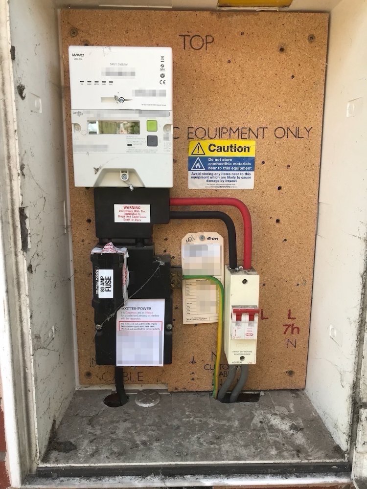

Currently (no pun intended!) the feed to my garage is a 6mm cable from the house consumer unit to another consumer unit in the garage. That's been fine for years, supplying a 32A ring for 13A sockets, plus a few other 16A sockets.
After reorganising the garage layout, the consumer unit needs to move, but I'm also going to need a 32A socket for a new compressor. I'm planning on taking a separate feed from the meter box over say 20m of 16mm SWA, run externally, clipped to the wall, into the garage. While I'm doing that, I might as well replace the garage CU, and use RCBOs in there. I followed @RaceDiagnostics thread with interest, as that's pretty much what I want to do.
There's not a huge amount of space in the meter box to play with:
It'll be easiest to bring the SWA into the top, into a fused isolator. What would the resident sparkys recommend for splitting the output from the switched isolator? Henley blocks, or is there an isolator that can take two pairs of tails on the output?
