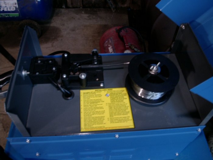

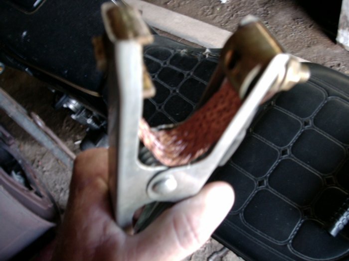

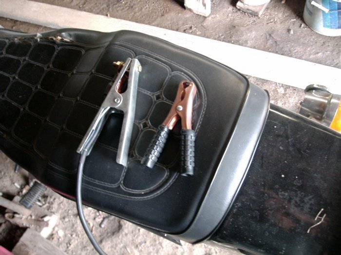

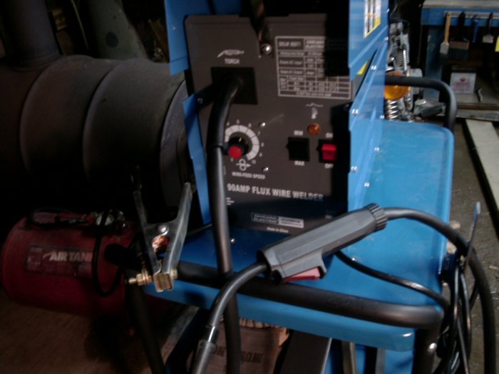

I bought a harbor freight gas-less mig welder off of e-bay for 23 dollars,I had heard all the bad things about them,I have a lincoln ac 225 stick welder but it runs off of 220 and I only have a 220 hook-up in my laundry room for the clothes dryer so I wanted a mig that would run off of 120 which I have in my workshop.That is one of the reason's I bought the hf welder plus the cost.I am slowly upgrading it to work better.The first thing I did was to buy a better ground clamp,the one that came with it was just about useless,you would have to put it right next to where you was going to weld to get a good ground.I have a friend that works at a welding supply company and I got him to order me one from lincoln electric.It only cost 14 dollars plus it has the copper shunt so that both sides ground.The next thing was to buy a knurled drive roller being as this welder being gas-less came with a regular roller,the knurled roller made a lot of difference,wire has not slipped once plus very little pressure has to be applied the the adjust on the wire feed,plus I done the sip mod on the wire feed....I have had no other problems with this welder as of yet,seems to weld decent for a 23 dollar gasless welder
