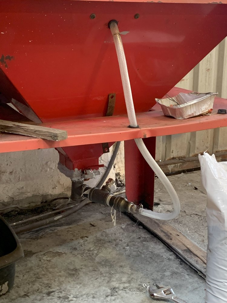

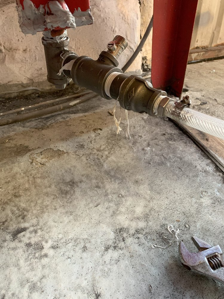

Fitted it over the weekend and no matter how much PSI I use (tried it from 45psi all the way to 90 psi) or how open or closed i have the air valve, it dosent draw any media to my gun?
Thinking it wcould be a problem with my media as it was old I order new stuff. some Draper 40112 shot blasting grit.
I get the whole concept of the venturi affect with the valve and i do hear air coming from the 'air valve' when i open it so the valve seems to be ok and not the problem.
I've got negative pressure in the cabinet when the doors closed and the extractors on, so muc negative pressure that the gauntlets will sit horizontal without my hands being in them.
Compressor seems to be running fine, it fills the tank from empty in 3 or 4 minutes.
Unsure what I should be looking at as this should be a simple set up?
