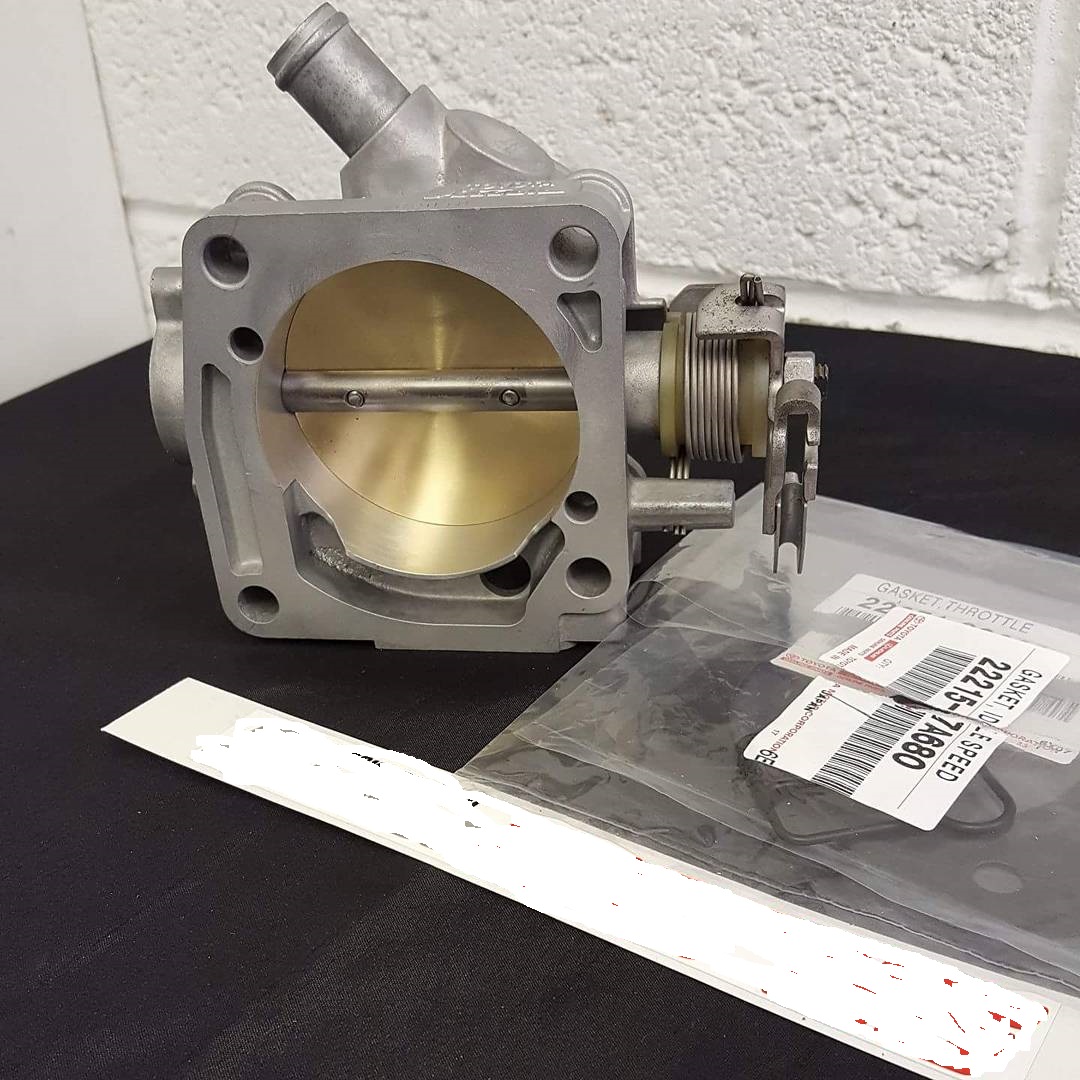

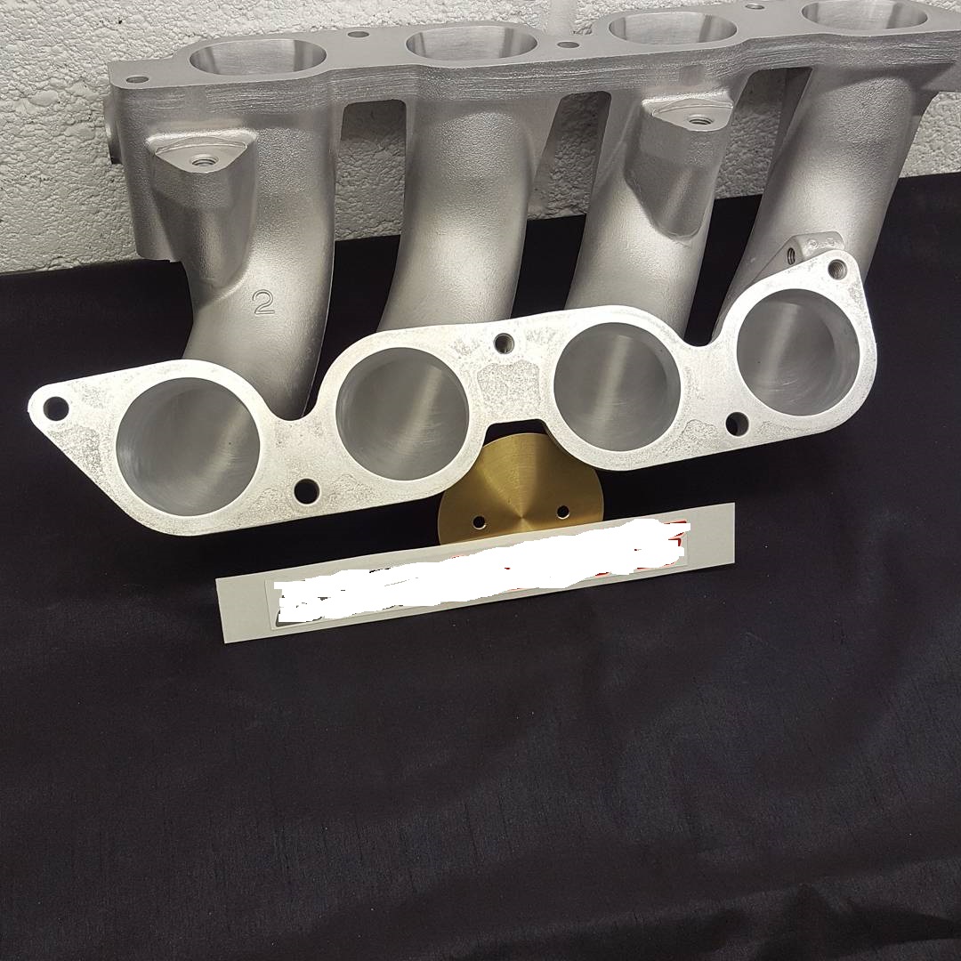

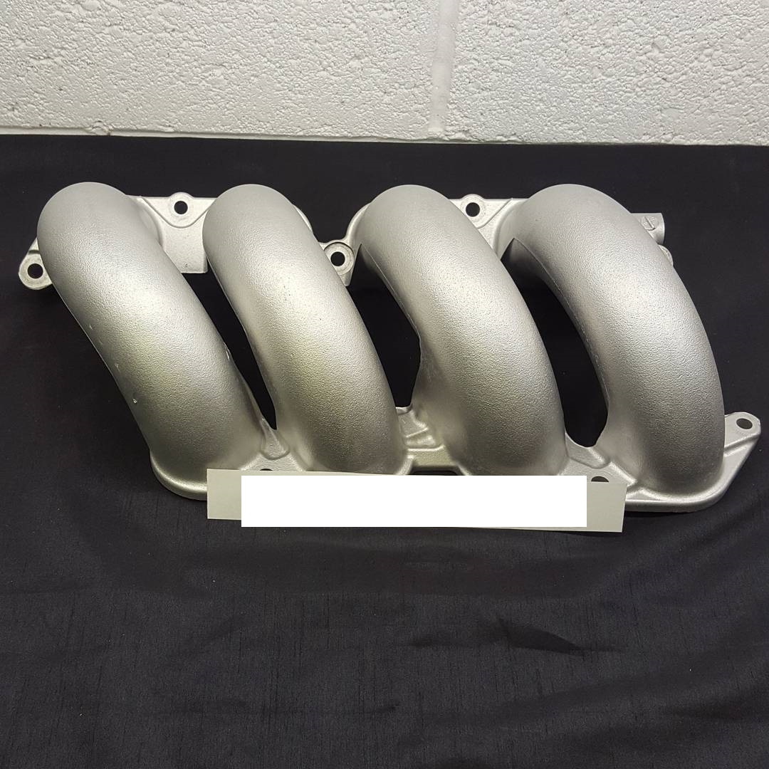

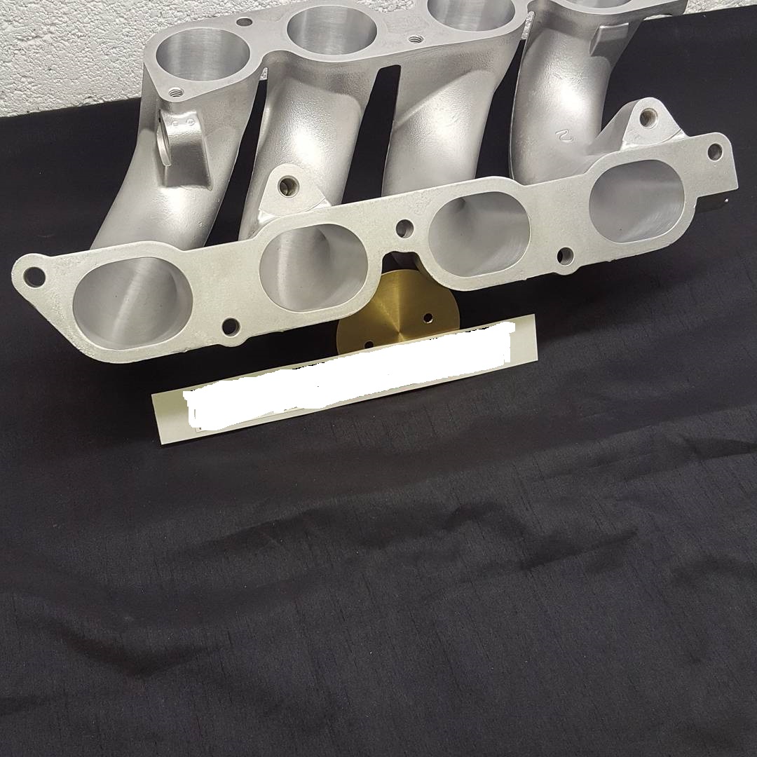

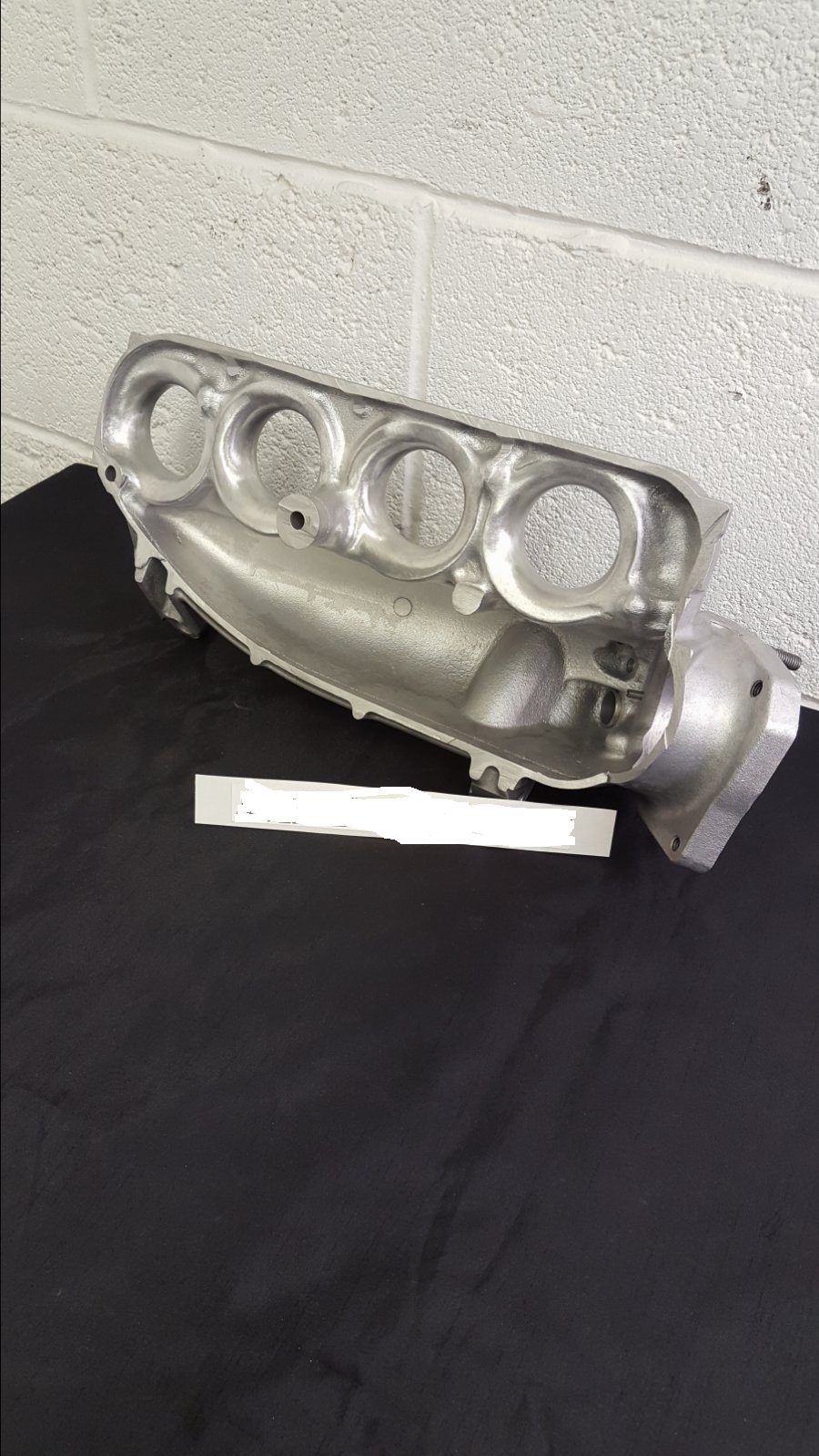

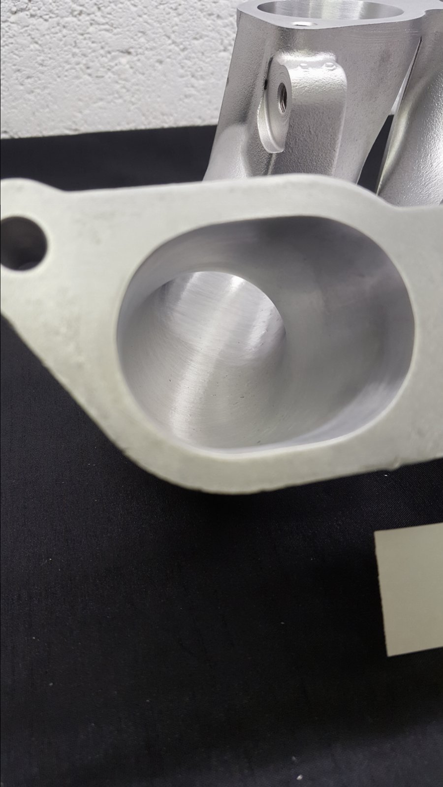

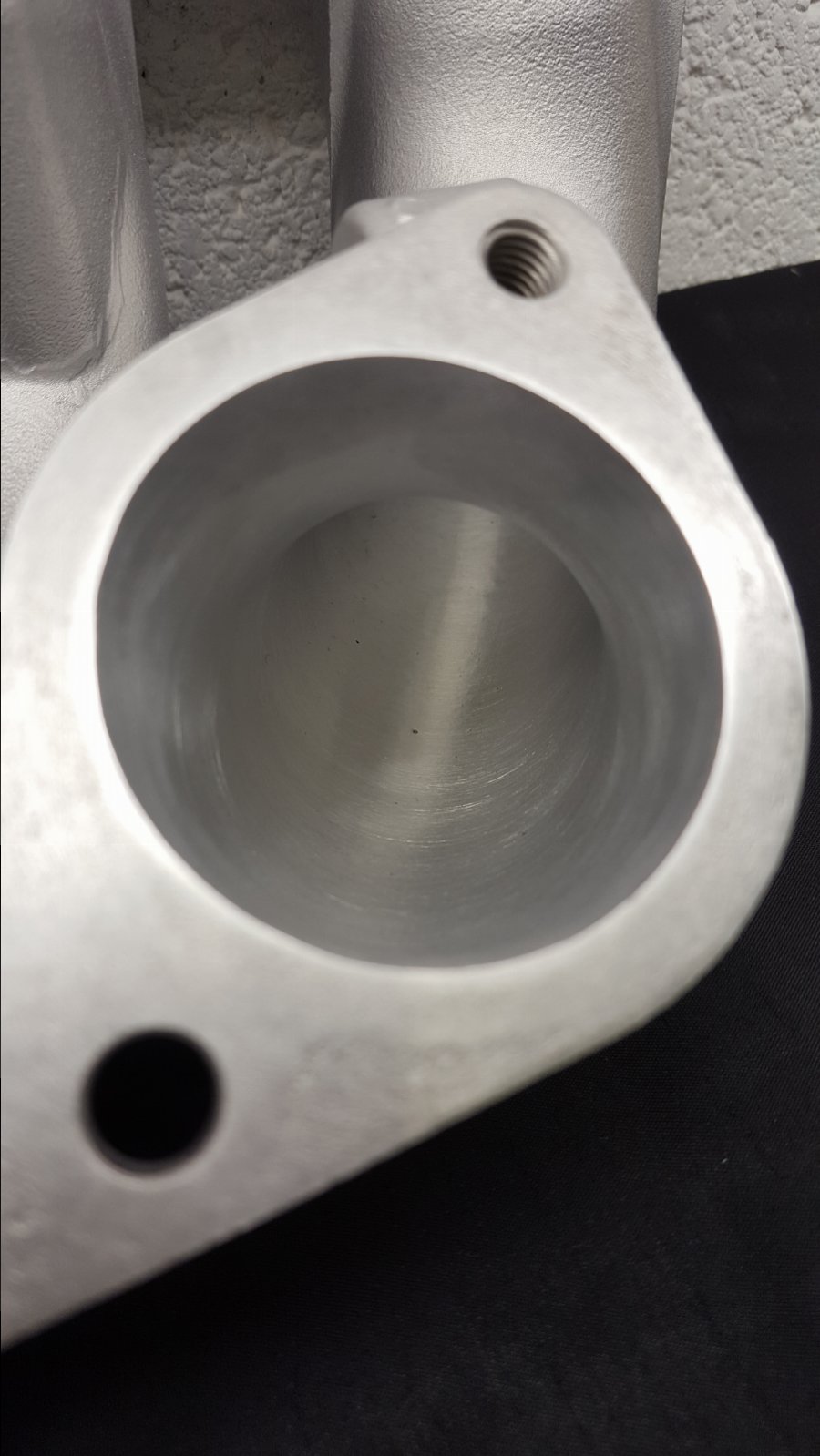

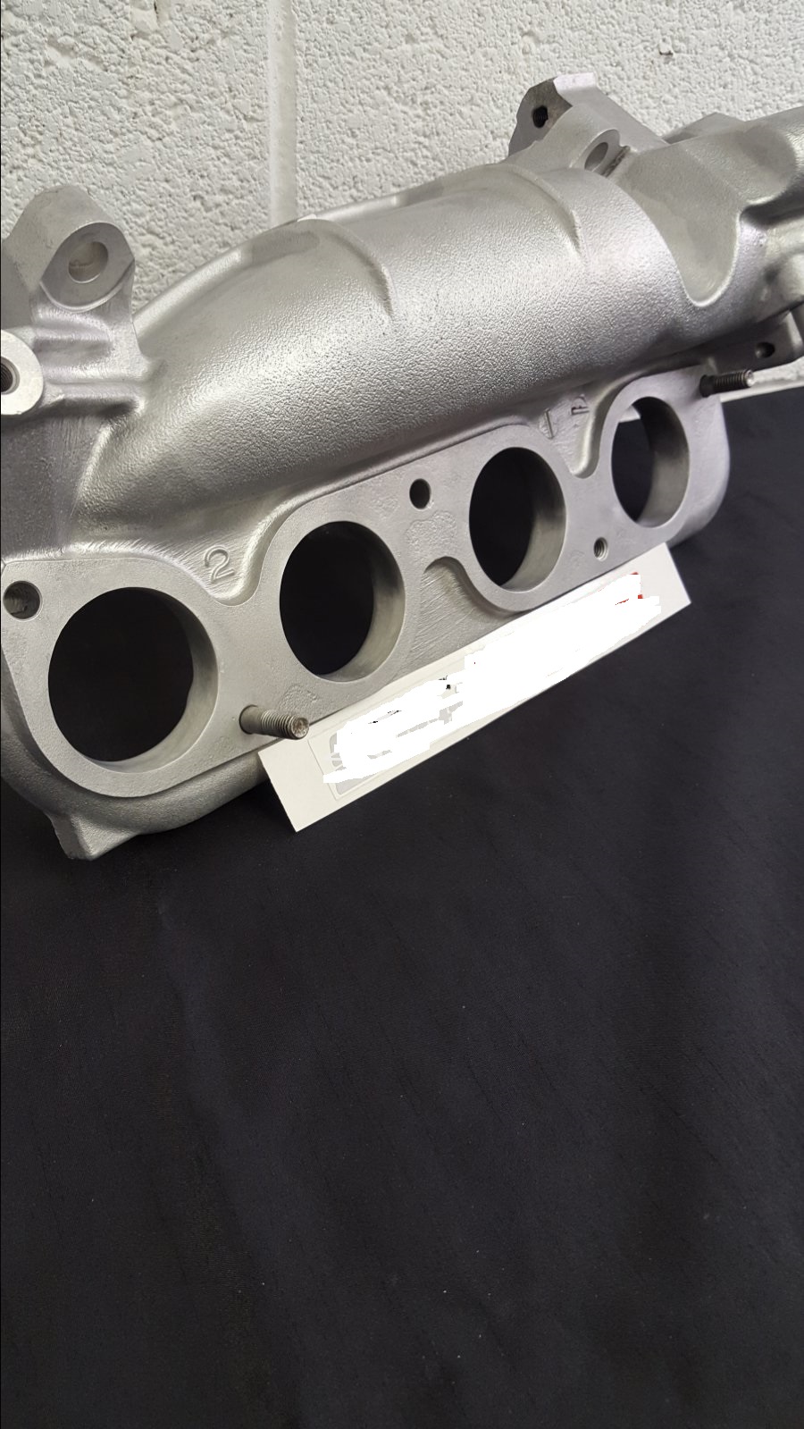

After outgassing and wet blasting we have lightly blasted the runners with glass beads after porting but before the final polishing stages. The outgassing and wet blasting has certainly improved the end result no end and less media contamination which I would call a good result!!
