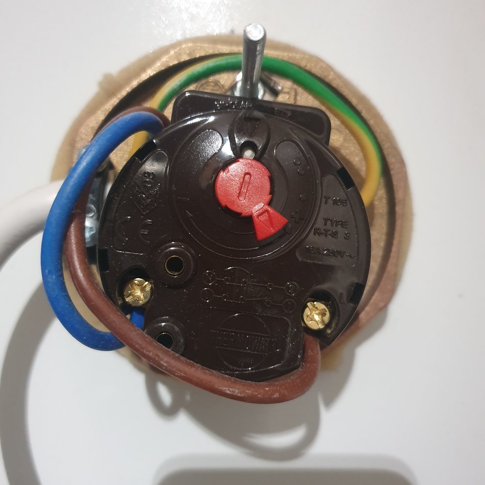

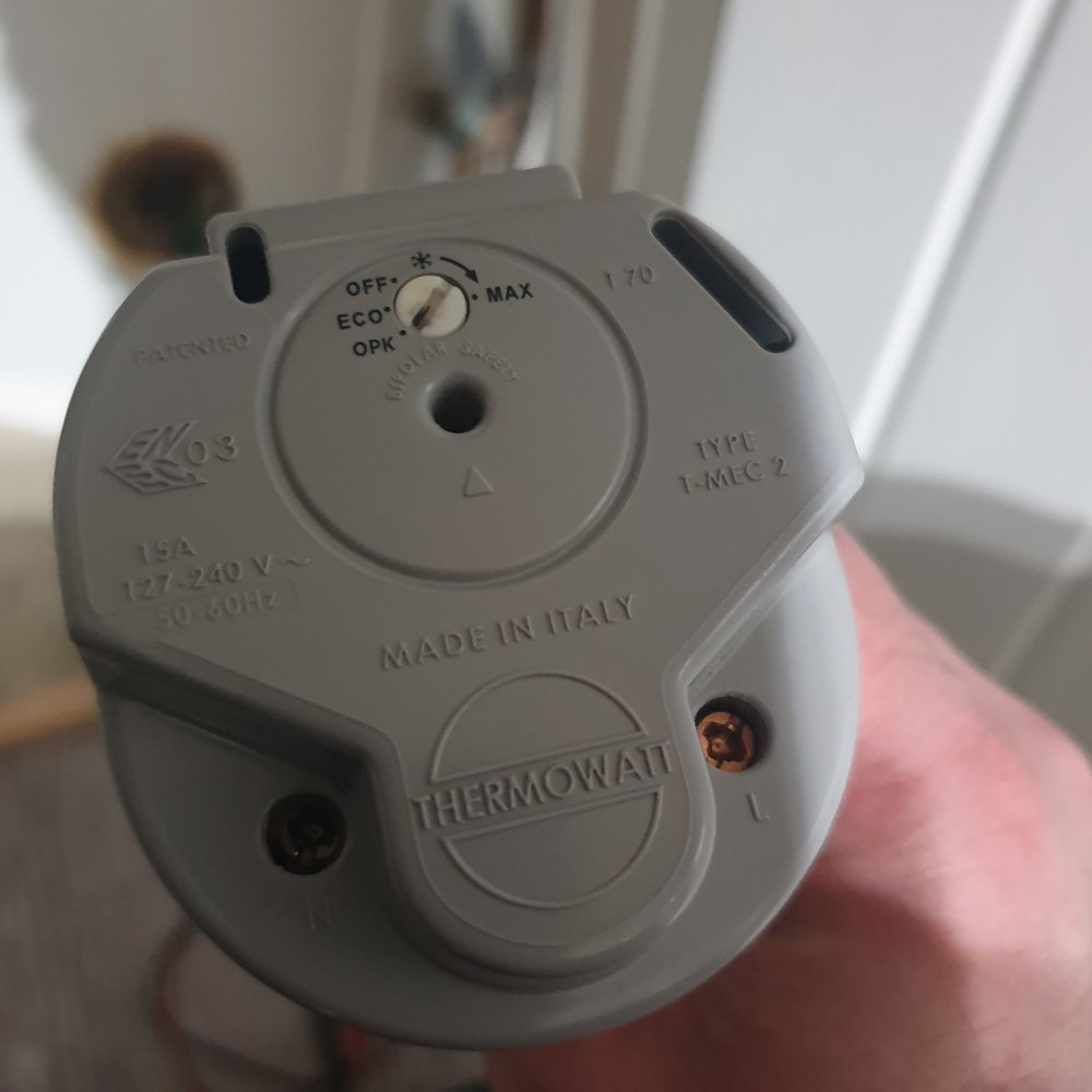

Unvented HW cylinder thermostats.. Bottom one, so Eco10 one stopped working. Upon an investigation, theres a melted terminal and corroded wire on the thermostat.
Checking the element, I get 19ohms, so I guess that should be okay with a reading like that.
Can I just change the grey type which I believe is some kind of intelligent (or not) affair, and stick a normal one in like the top boost element...?
