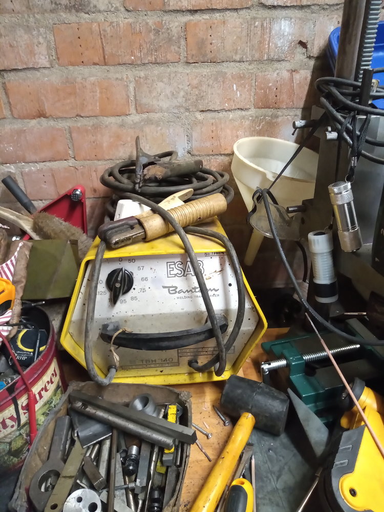

I aquired one of these, as a freebie , it's an ESAB AC transformer with multi tappings, no moving core, i thought it would be a nasty buzzbox, and tested it before i put it on ebay, but it's brilliant, it's as smooth as an inverter, and loves eating cheap SWP electrodes. And does not buzz.
The duty cycle was pathetic, but i stuck a fan in there, and now it has never cut out on me yet, and i did 3 x 450mm double vee'd welds on 6 mm plate with it. It's already earn't its keep many times over.
Sadly it refuses to burn a 7018.
the numbers in Sharpie pen are what it actually puts out running off my 6kva generator.
