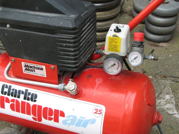

My Clarke Ranger 25 compressor was fine until the other day. Apart from the odd bit of baked oil sitting on the NRV and causing a slight leak, which was easily fixed, it was great.

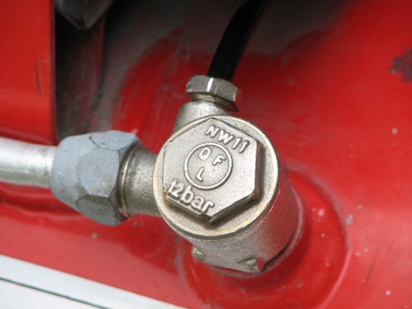

Now when I switch it on, the unloader valve is continuously venting out the pressurised air. It's coming out of the hole in the centre of the pic below. The air pressure does build up, but very slowly
I have taken apart the NRV and cleaned it thoroughly. The spring seems ok, the rubber washer is as flat as it can be on the mating surface, in fact I think it's a new one. This is what I mean by the NRV (hopefully its the right name)

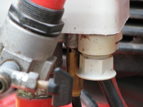

I'm convinced the NRV is ok, so that makes me think the pressure/unloader valve at the other end are suspect.

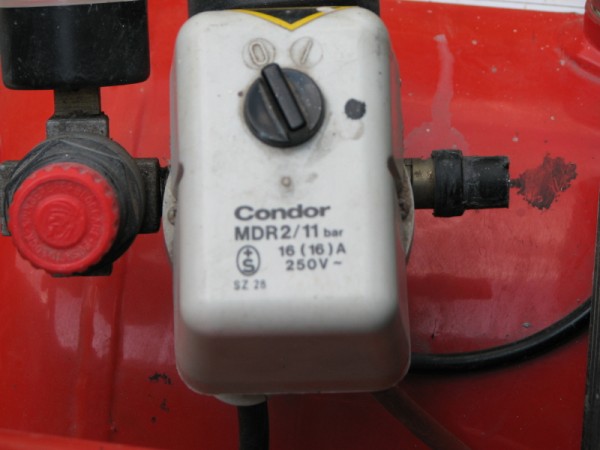

This is the pressure switch
Any ideas? Help !
