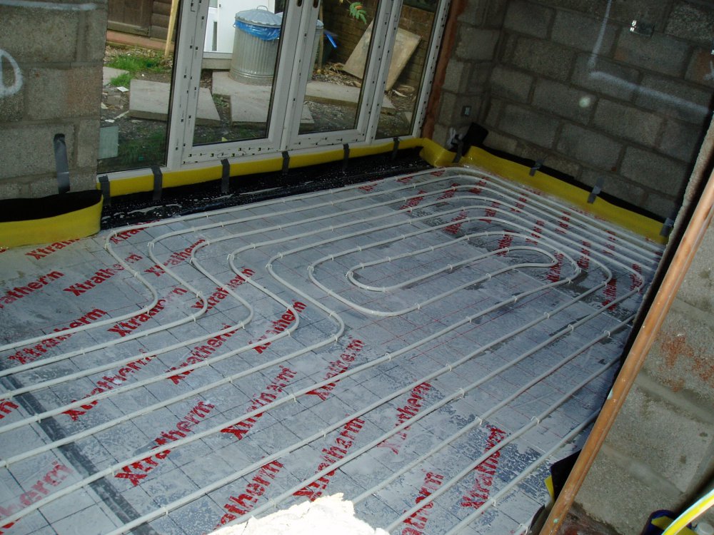

100mm concrete slab on suitable DPM ( may need Radon, ask building control) on 50 sand blinding on min 15o compact hardcore
100mm kingspan under or over floor slab, (I prefer over as easier with pipework install) with minimum 25mm perimeter insulation (under takes longer to heat up and slower to cool because of the greater mass)
get a kit for the pipework, polypipe and Nuheat will both design for you and supply a complete kit, usually in 50- 75mm sand cement screed
Good point it will need to be done to building regs. That probably rules out the idea as it's an old building and the foundations don't go 0.5m below floor level. The roof timbers are a bit low and there is a step up to the barn so I can't add 200mm on top of the existing either.
Sounds like the systems come with a mixer to cool the water down so can be plumbed into an existing boiler which is good news.
