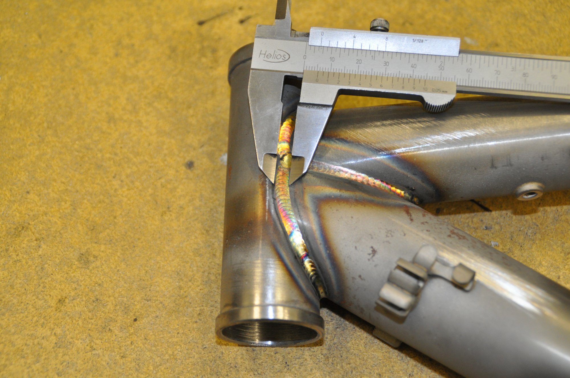

Hi all,
there is another bike framebuilder who has a very special technique to achive a very small haz and a wide and steady bead even on thin walled tubing like 0,6mm crmo.
The appearance is very unique and I was allways wondering how he achive these results úntil I saw a video.
He uses a very very short peak (just like a flash) and a long ground time. I guess also high peak current and very low current.
Mayby something I should try once a time.
But I think you should have a lot of experience to be shure that there is enough root penetration.
What do you think??
