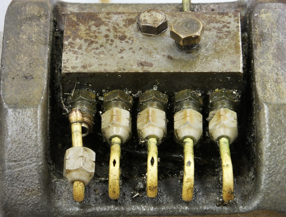

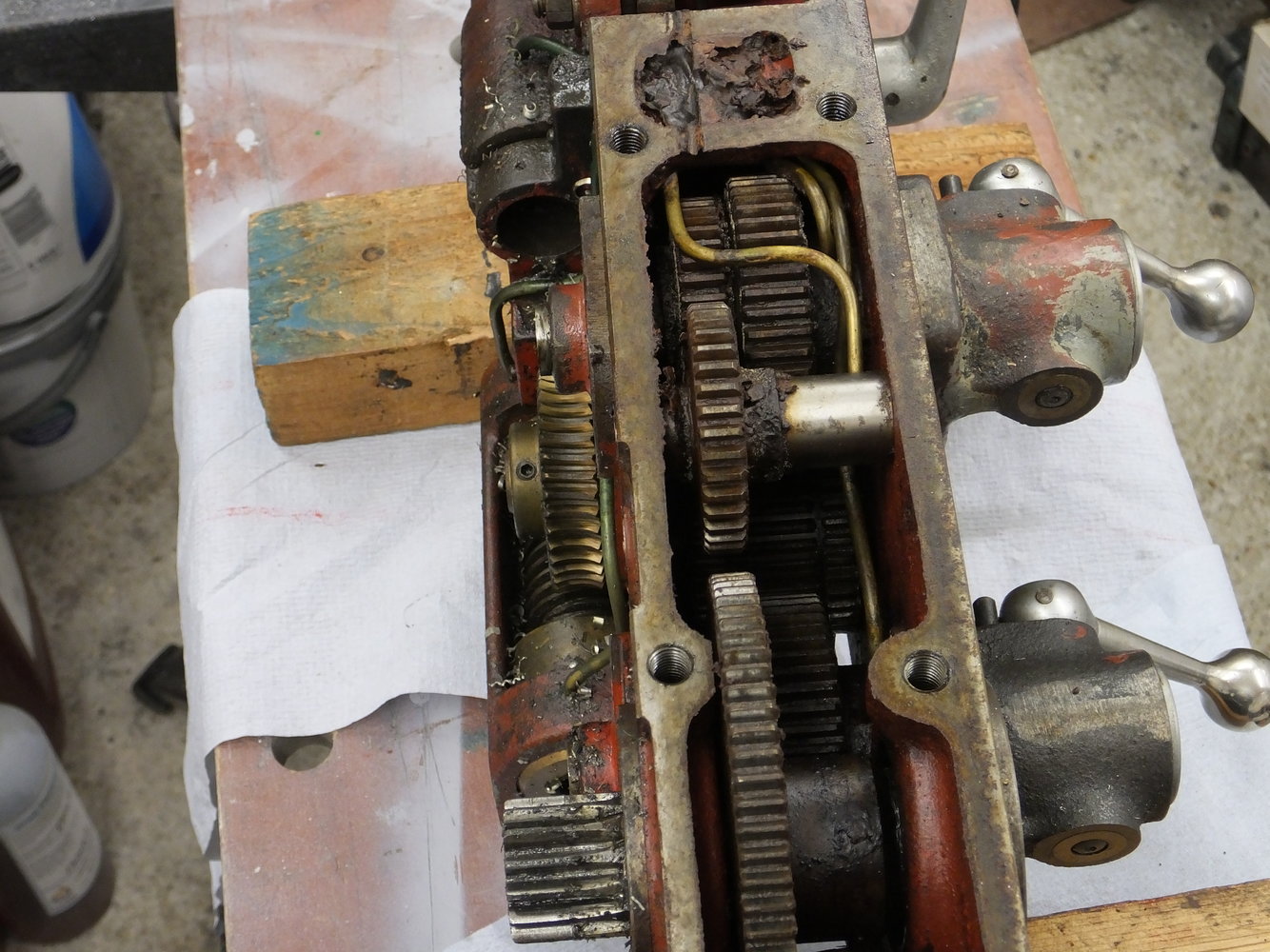

I'm in the process of stripping down the apron of my lathe (a CVA). It's very mucky in there!
Everything seems to be covered in brown sludge....at least it doesn't smell like C**P!
I will be taking all the internals out to clean.
Is this something an ultrasonic jobby would do or am I better off with wire brushes and harry-flynn?
If U/S is the way to go, any recommendations?
