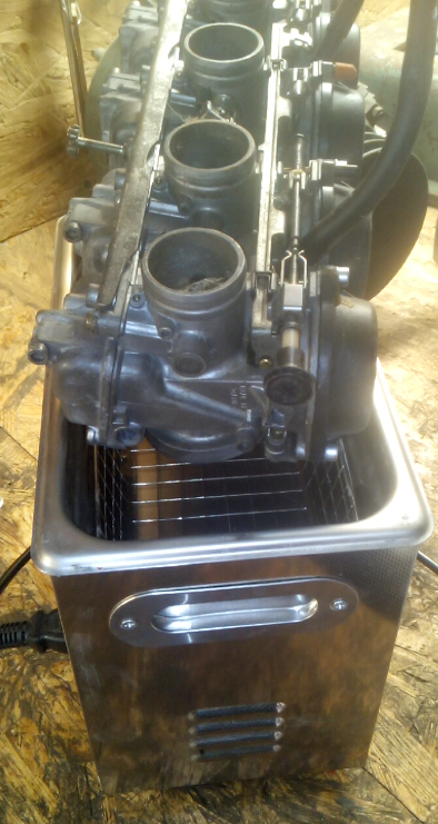

What are the approximate dimensions of the carb? There are a variety of 6L tank configurations. Mine is more horizontally oriented/orientated than some I've seen. I can check the basket size when I have a moment.

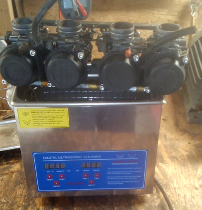

This is my 6.3-quart (6L) ultrasonic cleaner. It's been working very well for a variety of cleaning tasks. The cleaner is marketed by RCBS (a US company, part of Vista Outdoors) for cleaning ammo brass, but I'm not using it for that purpose. I bought it for general parts cleaning tasks. Probably manufactured in China, but I think it's pretty decent quality for what it is, and RCBS are known for good customer support (which I haven't needed yet). The inside of the basket measures roughly 275 x 168 x 50mm. Even though the max fill level is higher than the top of the basket, the instructions say not to place items in the basket that are taller than the basket, to make sure they are adequately covered with cleaning solution. So technically, your separated carbs might still be a bit too large, unless possibly you figured out some way to suspend them in the solution other than the basket and still keep them off the bottom of the tank.My carbs are 275x100x100mm - actually doesnt look to bad to fully strip, Ill have to read up on it. If seperated they are 70mm wide each.
