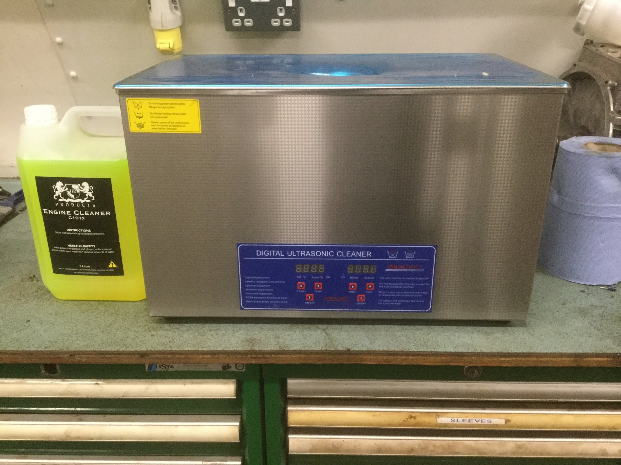

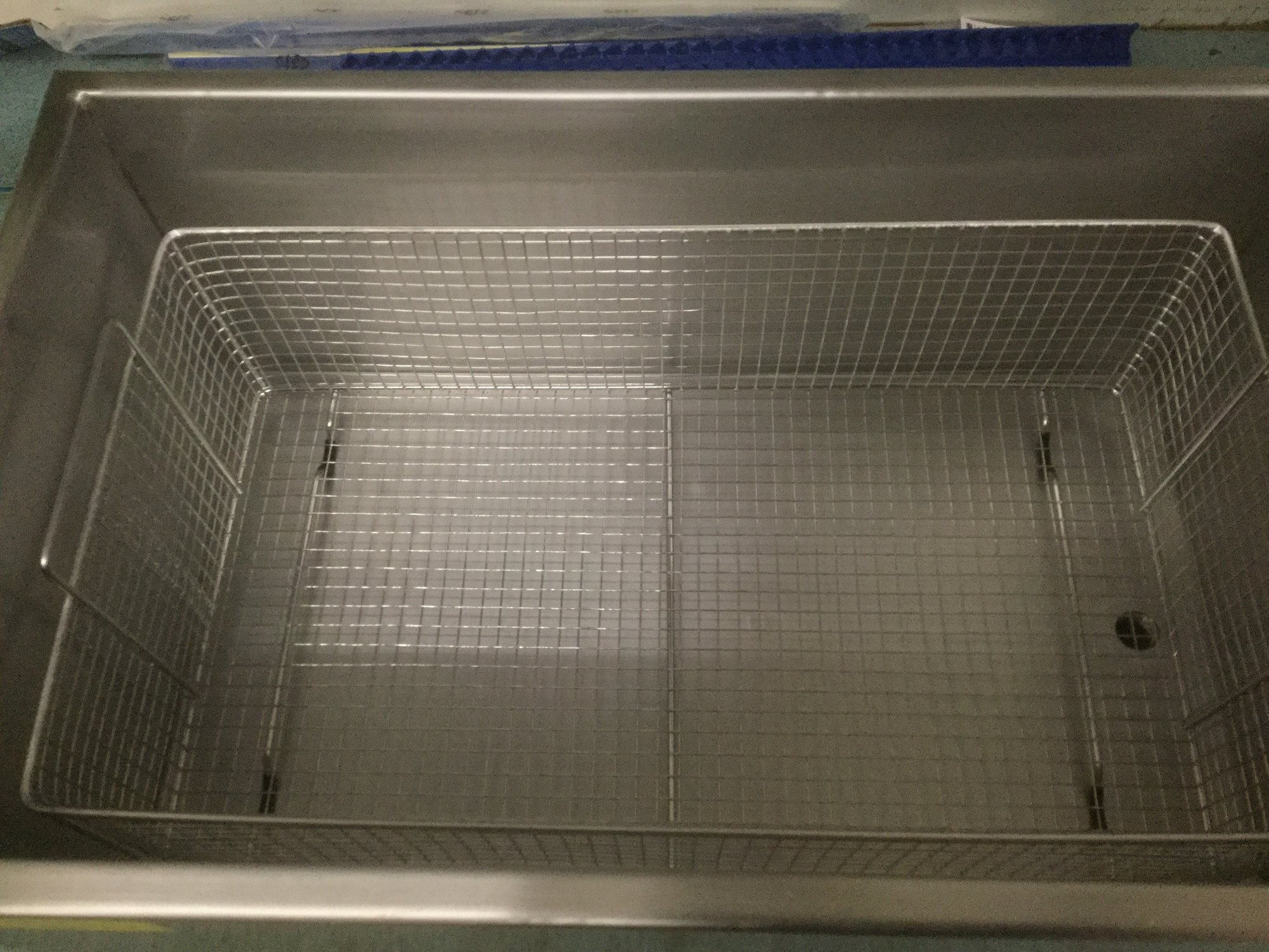

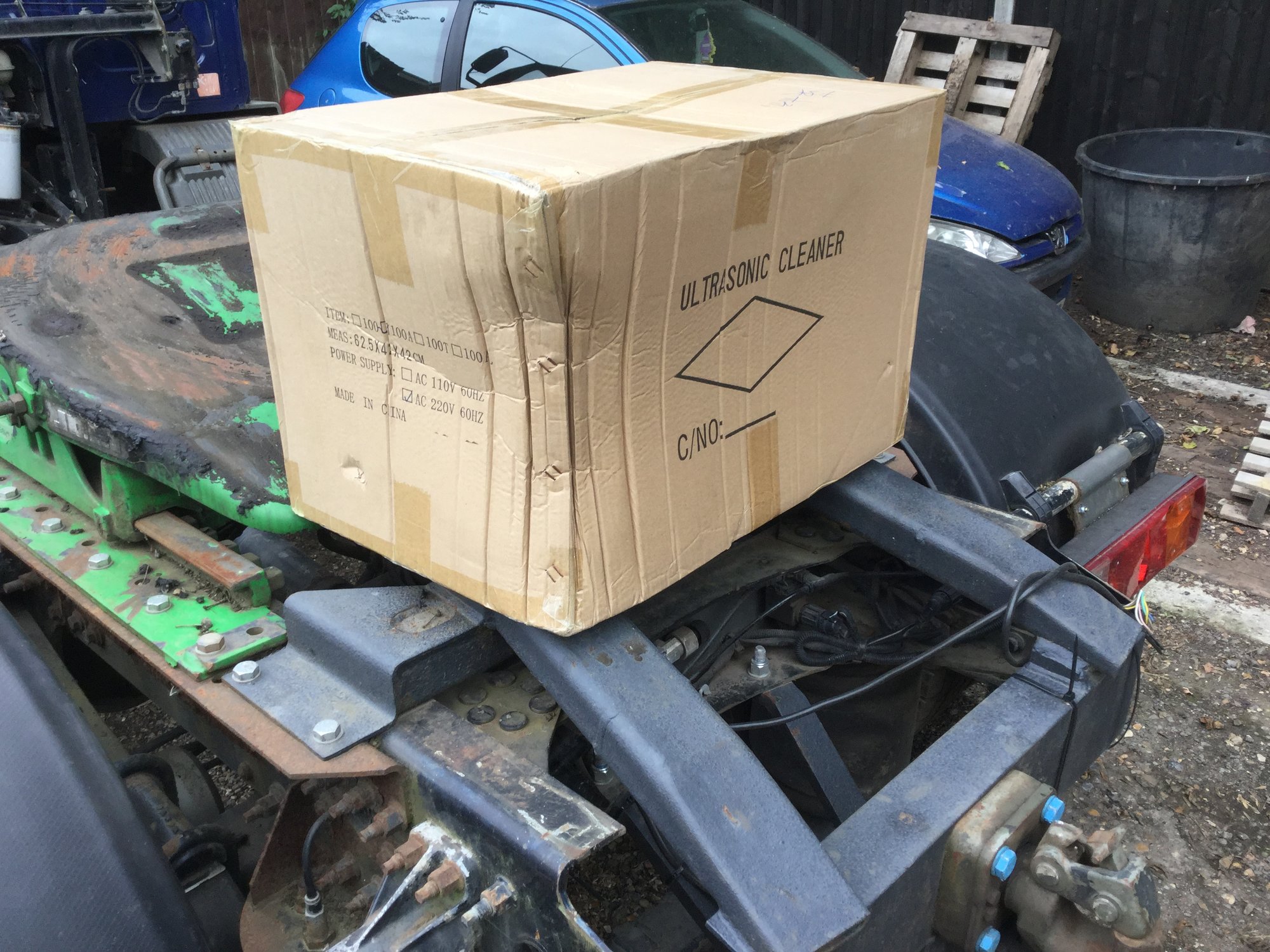

Got in from work today and:
arrived a lot quicker than expected
A piece of aluminium foil will show you its ultrasounding properly, drop a little bit in the tank and it'll poke tiny holes all over it.Think it has more to do with lack of cleaning solution than ropy piece of kit.

Soooooooooooooooo............ If I want to clean carbs is there a preferred solution for Ali and if the basket is full of bits does it slow down the process? As in do all the little ultrasonics become less effective when cleaning larger area`s
