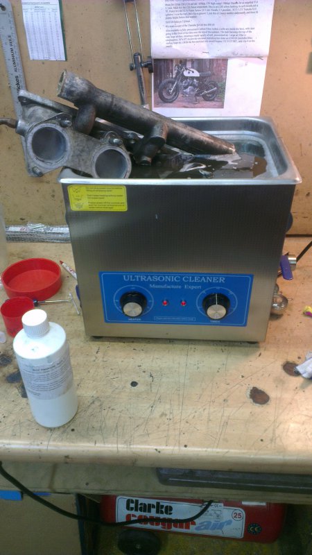

I actually filled my little cleaner with neat acetone once as a test after reading someone recommending it on the net... Sat outside on a extension cable in case it self immoliated. It stank, it didn't get the parts any cleaner and I can't see through the clear plastic lid any more after the heated fumes softened it and turned it opaque. Hand cleaner when i need the abrasive, bit of fairy liquid and hot water out the kettle is the best combo after experimentation with some commercial and homebrew mixtures to use in it.A lot ofthe time I have mine full of water. I then place the item/s in plastic bag, with cleaning agent. Suspended in the water. Keeps the mess down, and you can use flammable liquids
