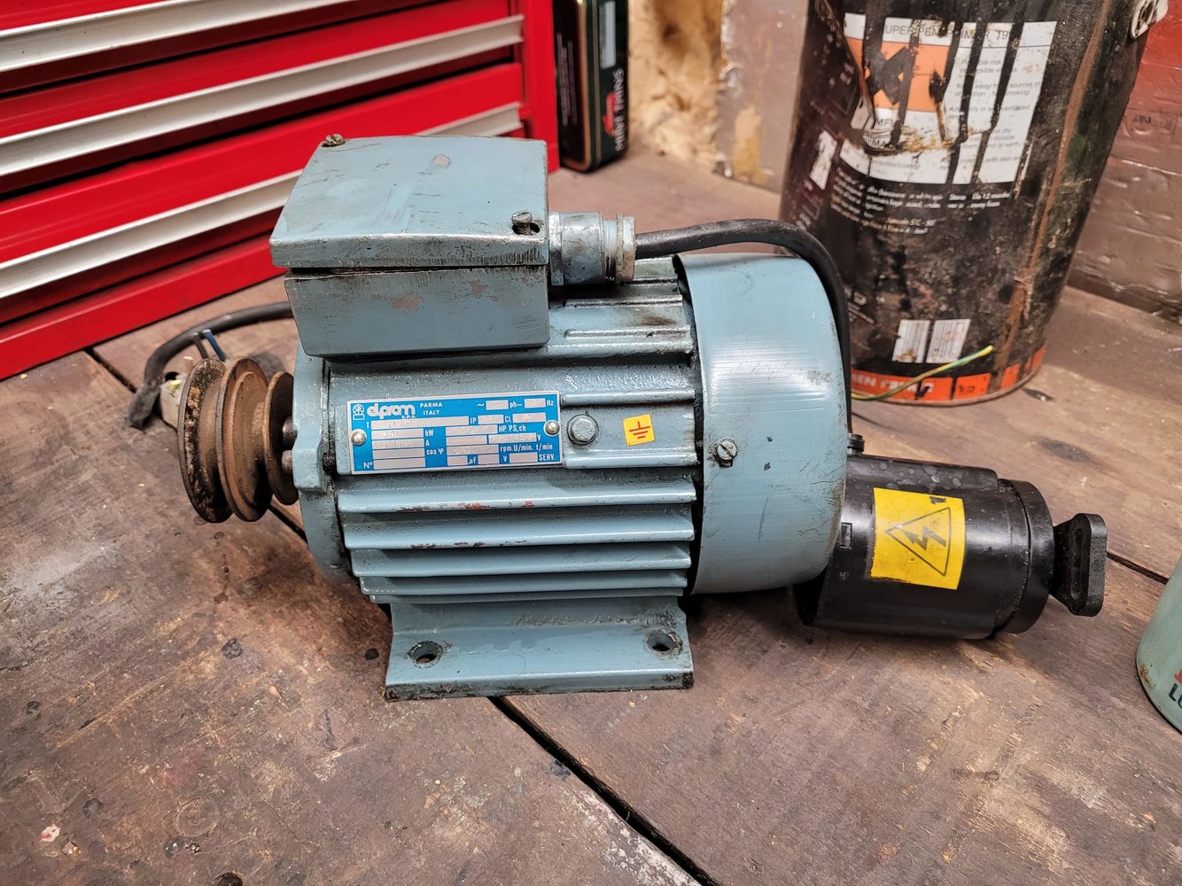

How long would the latter last?

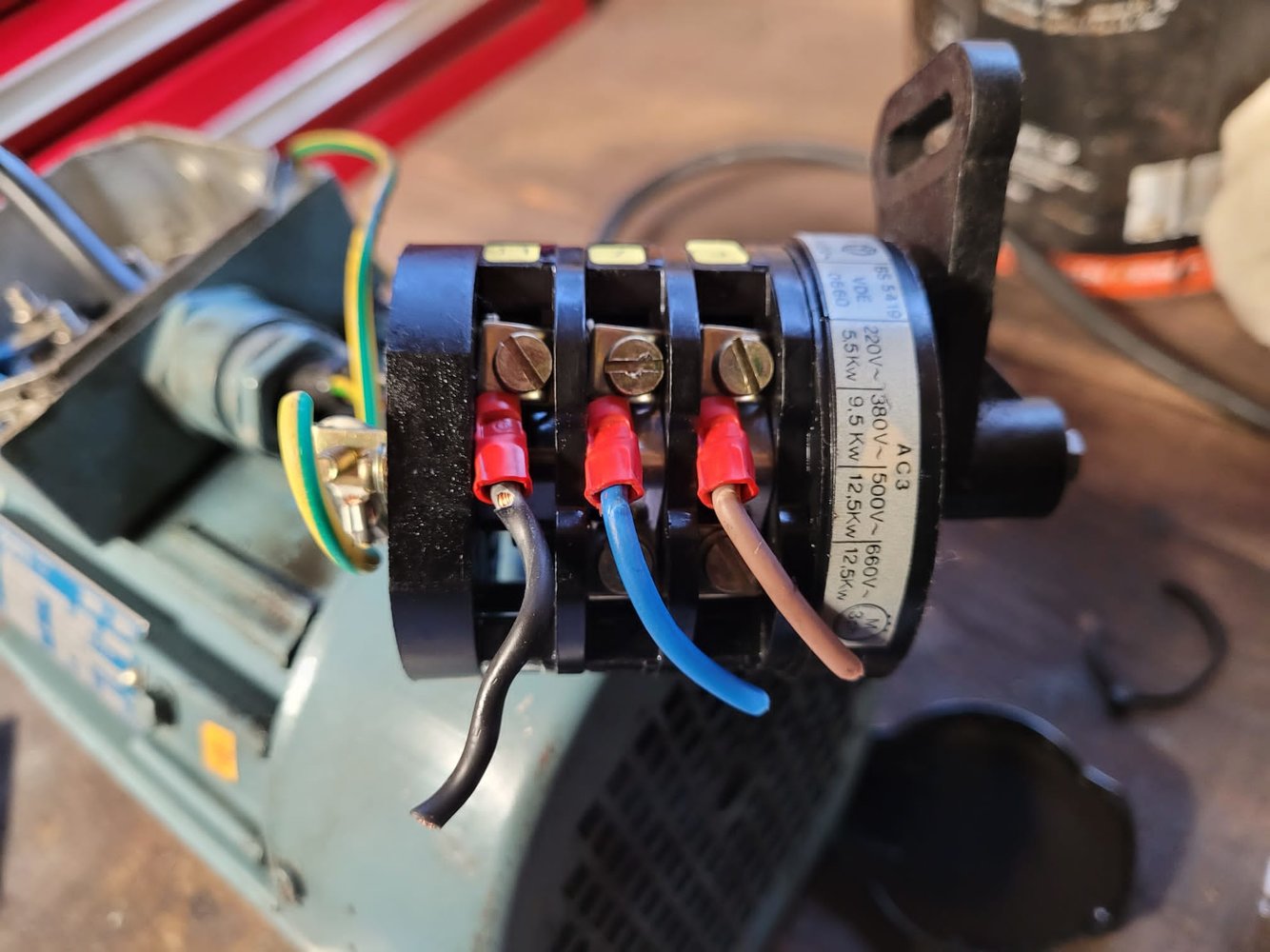

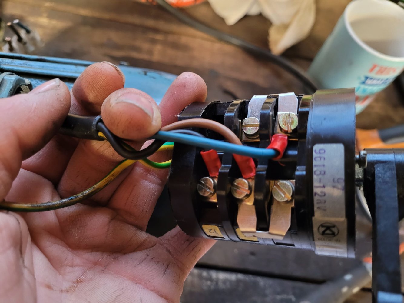

The big black thing will be the switch that gets actuated by the foot pedal.
I imagine a tyre machine wants to have a fair bit of torque? Or not?
As @armalites says, they don't need that powerful a motor. Tyre machines typically use a pretty high reduction worm drive gearbox, as they only turn about 10-20rpm.I imagine a tyre machine wants to have a fair bit of torque? Or not?
