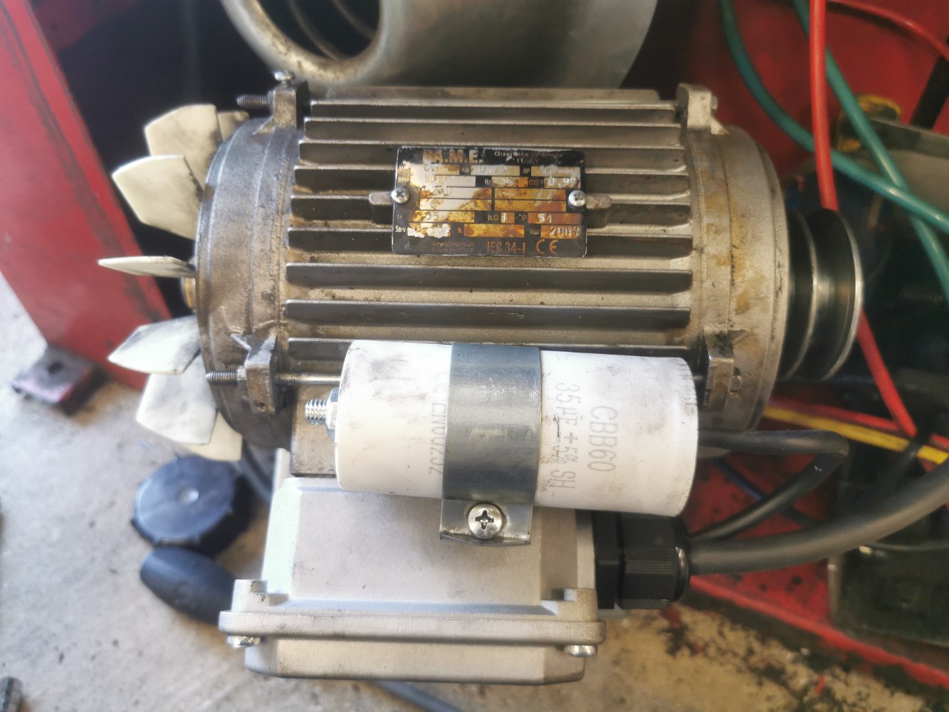

I recently acquired a broken cormach cm330 tyre changing machine.
When I went to collect it the garage said it had been looked at by someone who thought it was the capacitor but there was a bit of a language barrier so the repair/diagnosis didn't get any further.
Once I got it home the cap was clearly blown so I replaced it with a new one of the same spec.

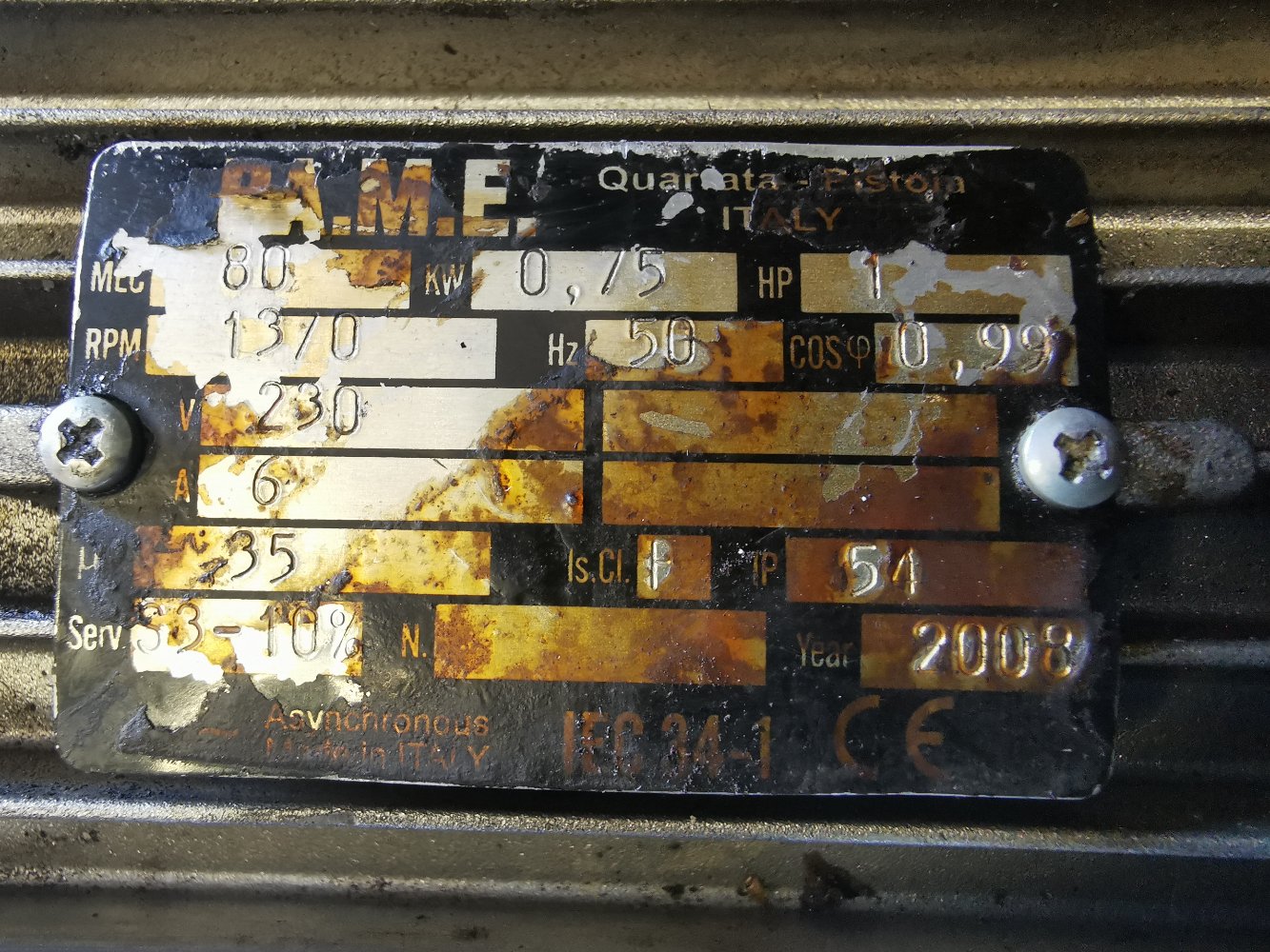

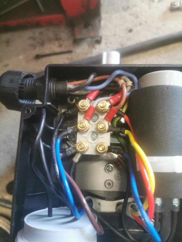

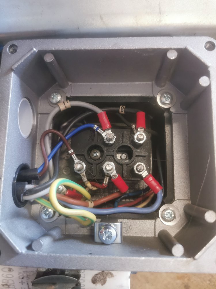

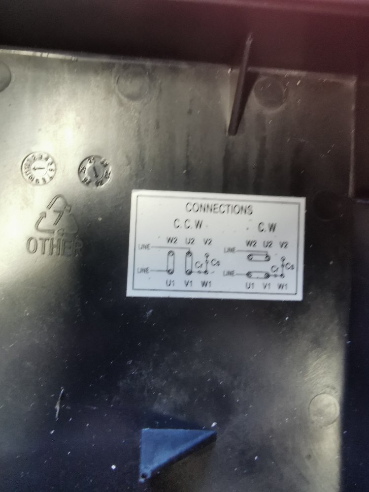

With the new cap fitted the motor will spin up for a few seconds and then blows the fuse in the plug so I'm guessing there's something further wrong with the motor, it does this with the motor detached from the turntable gearbox so it's the motor itself or the wiring setup.
There a few photos of the motor plate, it's wiring and the cap I fitted.
Can anyone see anything obviously wrong? Is anyone able to suggest a suitable replacement motor?
