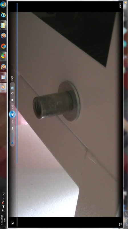

none if its the blast hose it wont last 5 minutes dont bother . just turn the air supply off to the potI want to attach a ball valve to the outside of My Cabinet to turn the supply of grit on and off from the blaster.
The outside connector on the cabinet, see screenshot. What style of ball valve would be suitable for attaching to it?
Cheers.
OK cheers.none if its the blast hose it wont last 5 minutes dont bother . just turn the air supply off to the pot
Why would having a ball valve on the side of the cabinet mess up the blast hose?none if its the blast hose it wont last 5 minutes dont bother . just turn the air supply off to the pot
u are talking the blast hose that carries the grit to the nozzle and not just the air supply hose on a suction gun .there is a big diffrenceWhy would having a ball valve on the side of the cabinet mess up the blast hose?

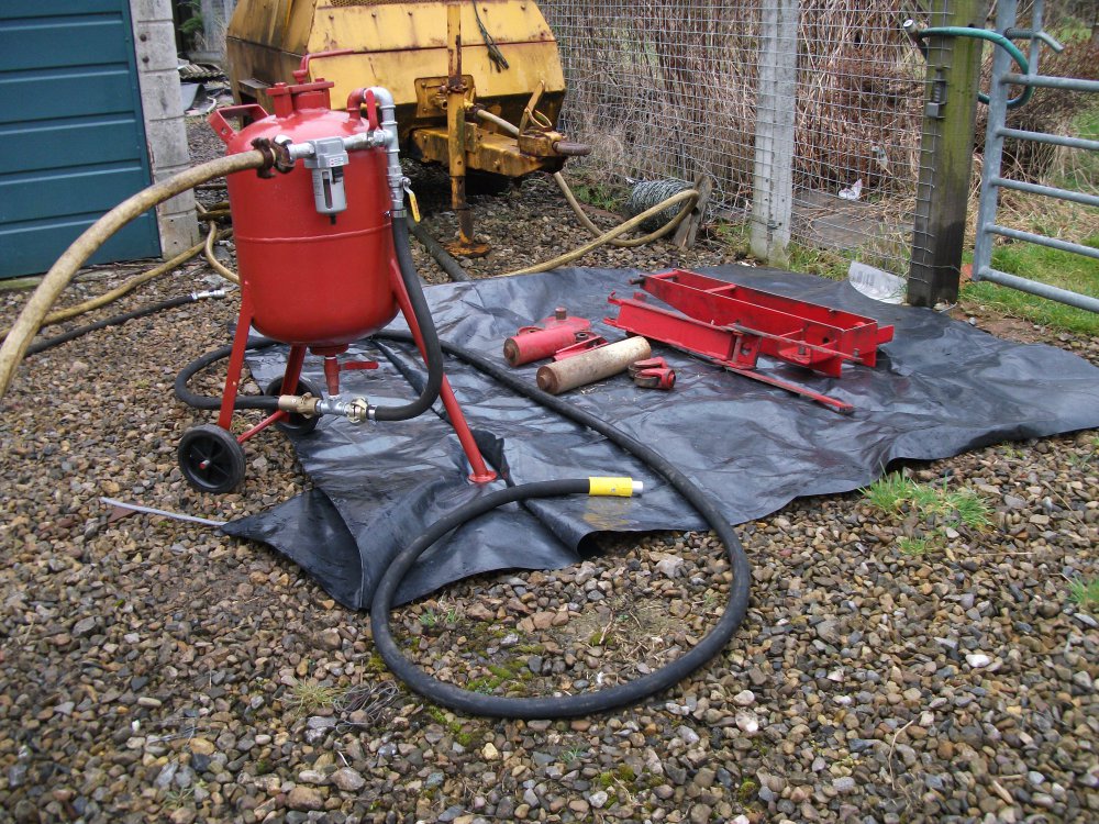

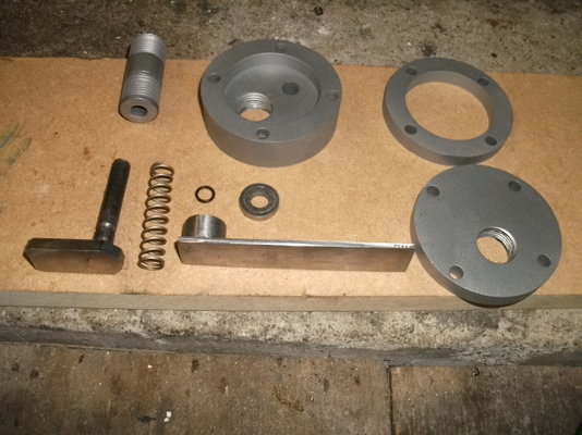

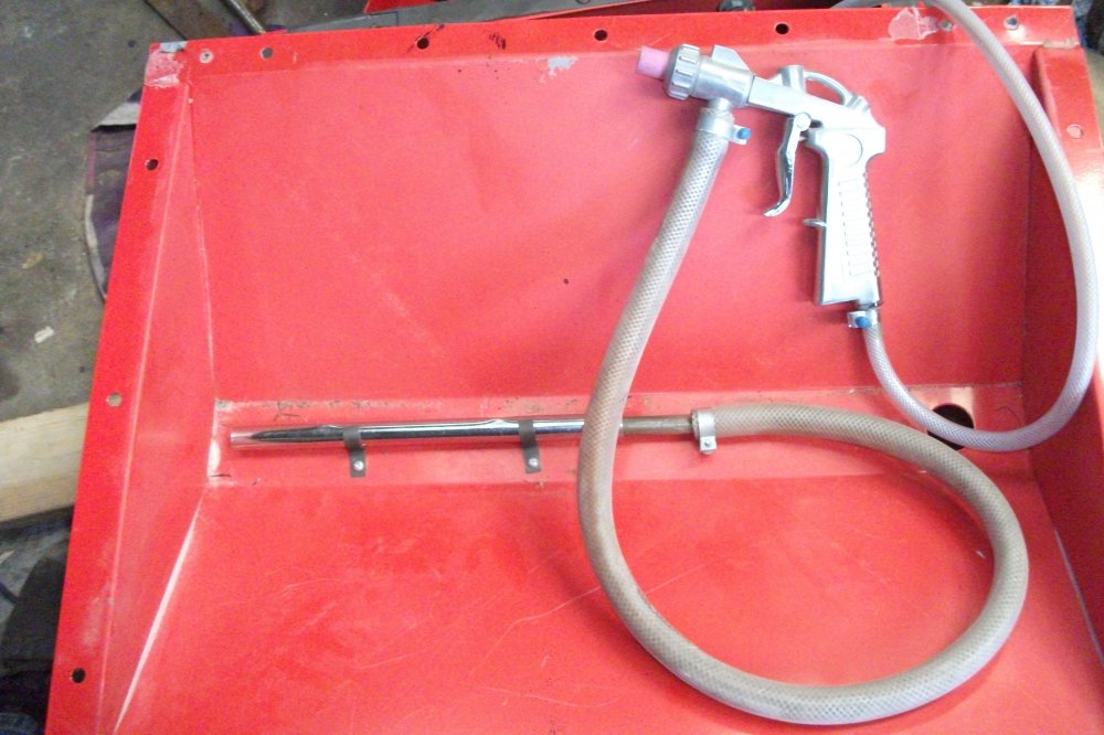

u could use a suction gun with a foot pedal to stop and start the air a lot quicker but it wouldnt be as powerfull. heres a few of mineDuh, I see, on the same page now

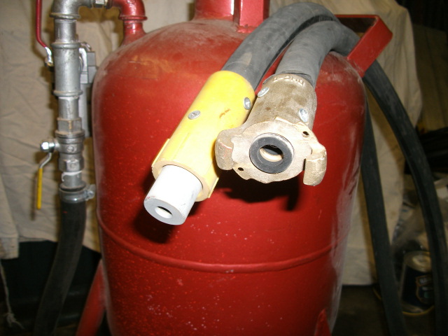

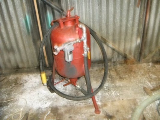

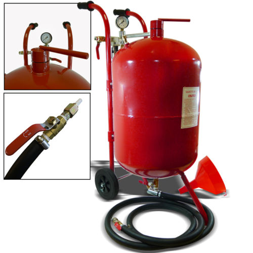

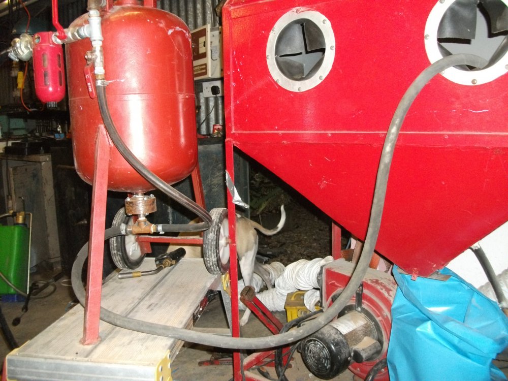

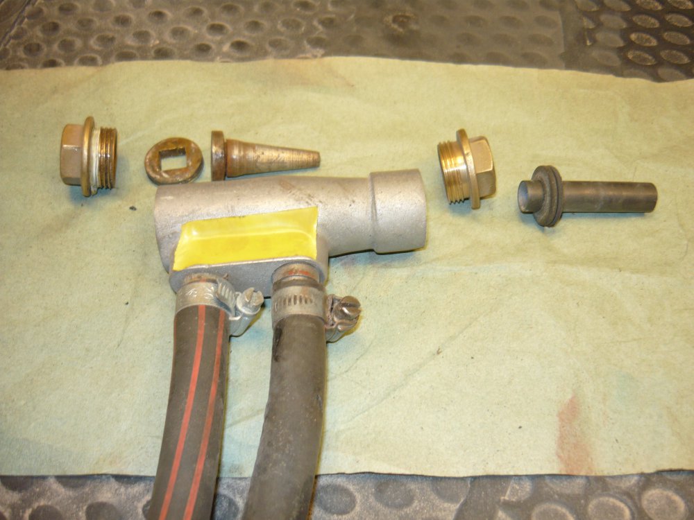

Hi again,i think u are missing the point. if u are using a pressure pot and blasting in a cabinet there doesnt want to be a ball valve fitted to the nozzle on the blast hose as the grit will wear it out verry quickly the ball valve that is NOT THE HOSE to operate the pot just turn the air supply off and on at the air supply inlet next to the water seperator heres one of mine and heres another i made
