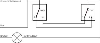

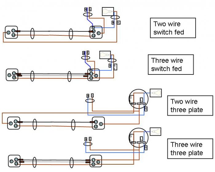

One for the electrical wizards. My daughter's new house has a couple of two-way light switches that aren't behaving. Switch A turns the light on and off as expected, and when A is on switch B turns the light off and on as expected. But when A is off switch B doesn't turn the light on - not as expected!!
A quick look inside shows that the switches seem to be wired correctly (or what I think is correctly)., ie COM to COM, WAY1 to WAY1 and WAY2 to WAY2. Switch A is also a dimmer, which works fine.
So - faulty switch? faulty wiring?
