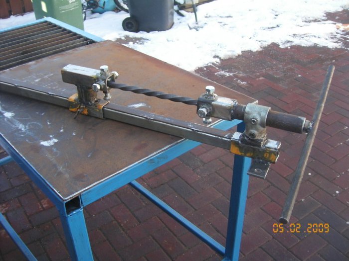

B brooker2008uk Member Messages 103 Sep 30, 2009 #1 i am looking to make a twister for square and flat bar, can anyone point me in the right direction of making one
A astro_al Rocket Scientist Messages 1,824 Sep 30, 2009 #2 http://cgi.ebay.co.uk/ws/eBayISAPI.dll?ViewItem&item=230383041955 Or do a search on here - someone made one. Couldn't be simpler really. Al.
gordon stephenson Member Messages 7,430 Location Skelton in Cleveland U.K. Sep 30, 2009 #3 Here is a picture from one of the welding forums, Very simple to make, only alteration it needs is for the twisting handle to be hollow right thro' to allow for twists to be put in the middle of the bar etc, twister2.jpg 69.3 KB · Views: 722
