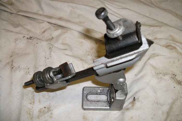

heres a picture of a drill grinding jig there about £12.00 to buy .good value for money .drills can be sharpened verry acurately with them .the only bit of a let down with them is the base clamp adjustor which is bolted down on the bench and has to be slackned off and reset whilst grinding takes place heres a drawing of much improved base with fine adjustment .well worth making
