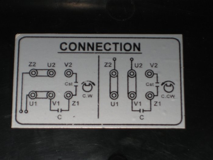

hi all,
had to swap the motor over on my small lathe in the garage on the weekend.
had an old motor, which looked original finally die on me.
anyway, have had a spare brand new motor for it for a good few years, which I eventually found and fitted.
the lathe has a forward and reverse switch, with 2 x pair of cables coming out to connect to the motor.
the new motor has 2 x pair of terminals for CW or CCW rotation. Simples.......
I connect the pairs as indicated on the terminal box of the new motor, from the switch, but after a few minutes running one of the capcitors is getting hot, I mean starting to smoke
I have removed this capcitor and the motor runs fine, and reverses, no overheating and plenty of torque, no problem.............
so what's happened? do I need to replace the capacitor?
I'm no spark, but from what I've googled, there's a start and run system?? and one cuts out when it is running? how does this happen? theres no mechanical cut out I can see, unless its buried inside the motor frame??
any pointers? should I repalce the capacitor or risk damaging the motor, blowing it up?
