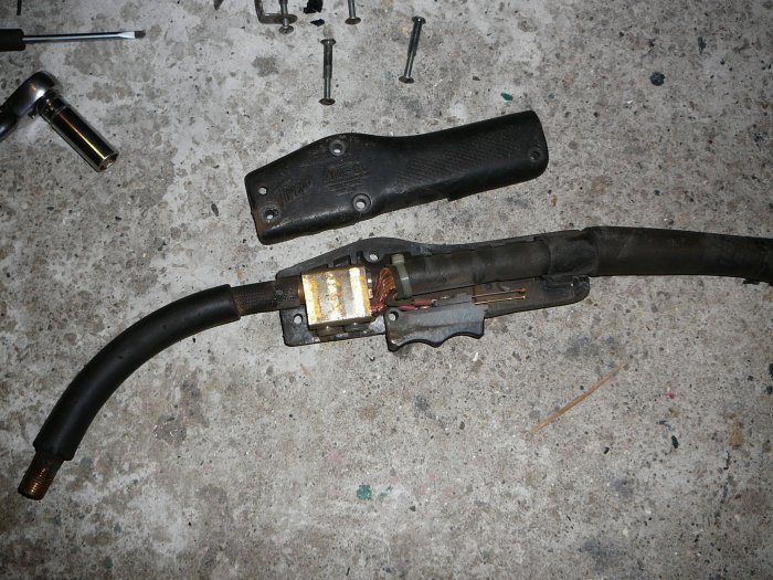

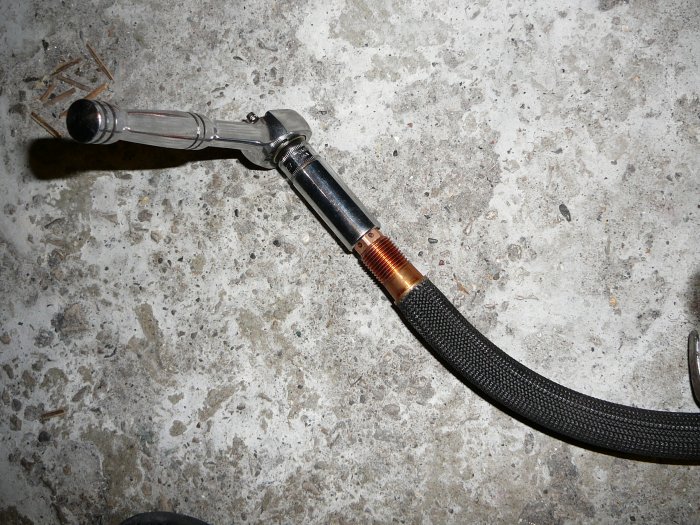

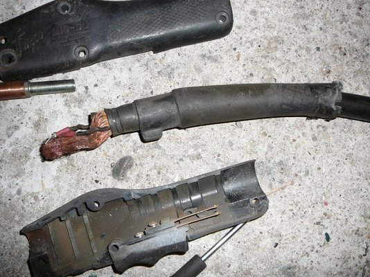

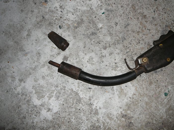

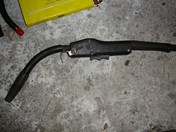

My torch is looking tired so time for a re furb got some nice new parts.
I start at the end nozzle,tip, insulator
and diffuser this has a small grub screw to hold the liner in place
next I crack the two screws that clamp the neck, I cant remove these yet.
Now the liner comes out, remove the retaining nut and pull (keep the line straight)
