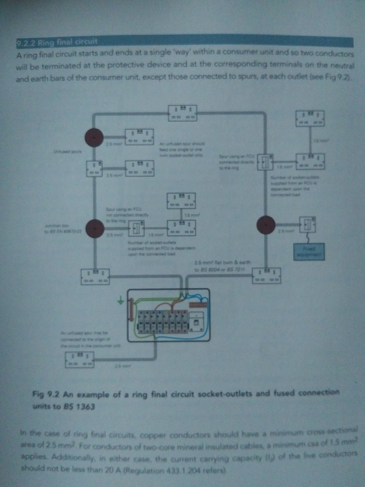

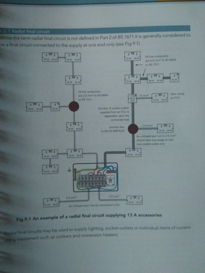

i have a double socket at the end of a spur.
I want to add another double socket to the spur, and thus need to add a fuse.
i'm going to go out on a limb here, and guess that I have to add the fuse at the "ring main" end of the spur - it can't be added in place of/just before the first socket?
I would ideally like to turn the "supplying" double socket into a single socket + FCU, but there is a need for two sockets at the location, and not much option/space for another fitting
