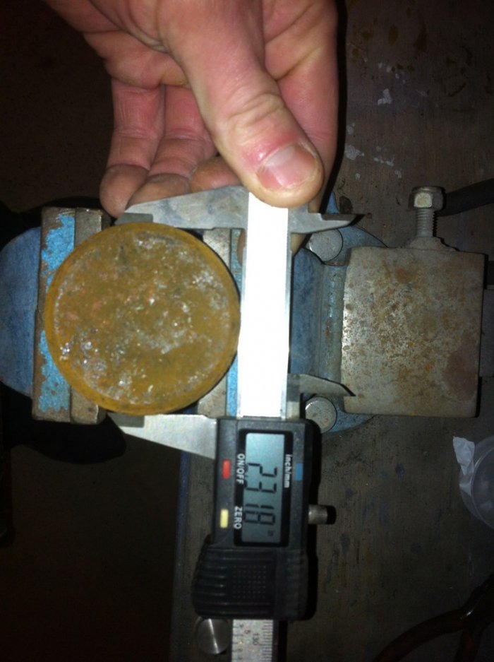

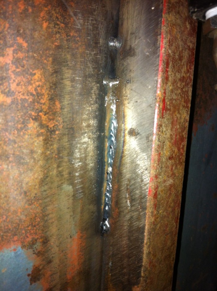

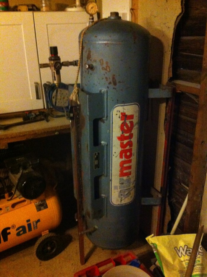

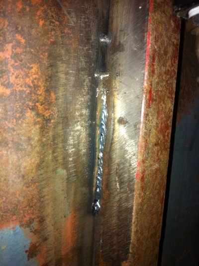

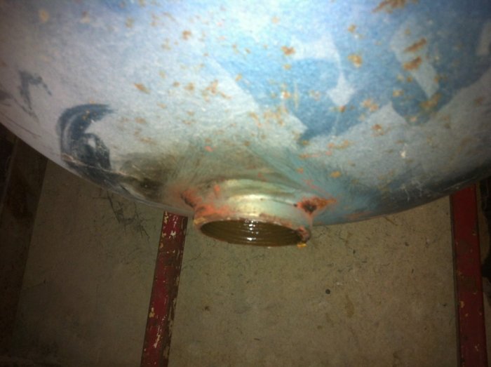

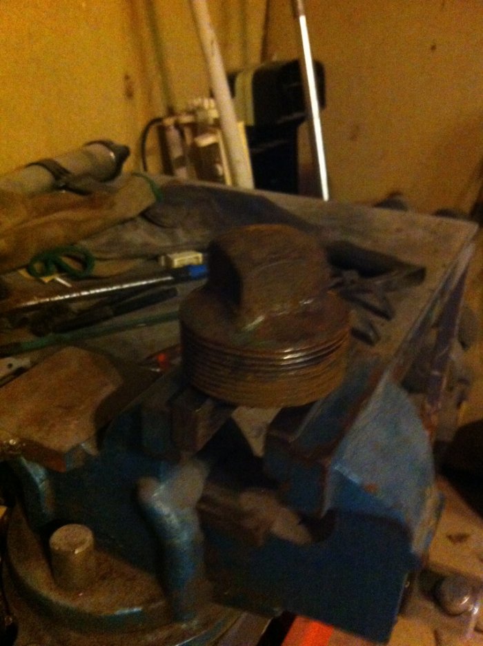

So I've finally got some time to tidy up my work shop and do some jobs I've been putting off for a while so I've wanted to flip my air receiver up on end to make it more compact as its some 150cm long it takes up some space well I've lifted it up on the engine crane and welded 3x1m 25mm box legs on too it now I'm left with a drain plug to sort out here's some pics anyway if anyone sees any flaws please do point them out
at first I was going to get it drilled and taped but its quite a chunk of steel.
Insurance problem big time
ive made 5 shotblasting pots and same amount of tanks for c0mpressors out of gas bottles {NOT CALLOR ]
