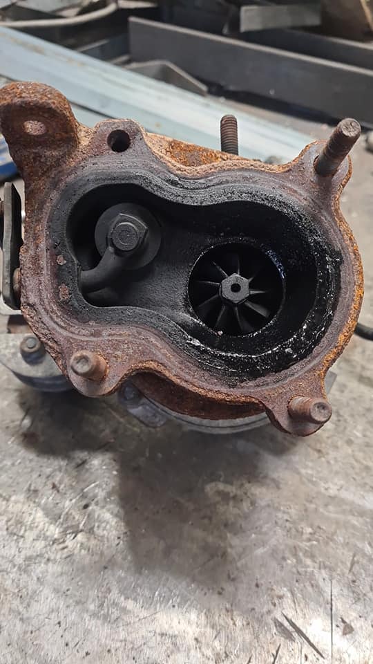

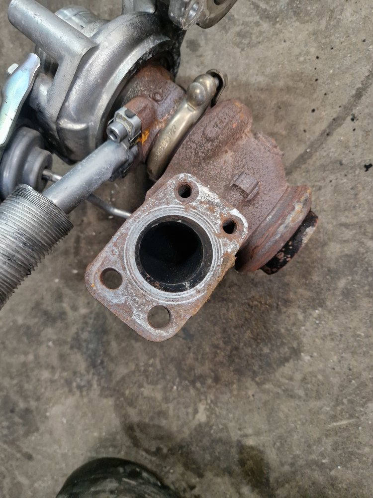

What bit is missing? Both inlet and exhaust side of the turbo is there.

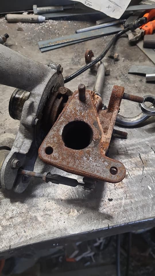

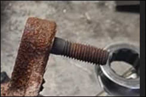

yep, wat peed me off was telling me it IS the one they removed and all turbos look like that aswell as the other they have. no reason but they ripped me off IMO and found my turbo wasnt wat they problem was and kept it. end of the day though, there loss as i was going to get them to fix the rest.There will have been thin metal gaskets on your turbo flanges so they won't have gone that rusty after a couple of days of exposure, I suspect it's not your original one. What you've got back does look perfectly ok as a core exchange though, they re-machine all surfaces anyway.
TBH I don't see any reason that could not be your turbo. Do you have any 'before' pics? The compressor should be easy to match to a photo.
so your saying a gasketed flange froma running engine would be that rusty?
i have stripped many engines and never seen such rust on a flange. even the two engines from y boat that are near 50 years old and not run for atleast 10 years.
