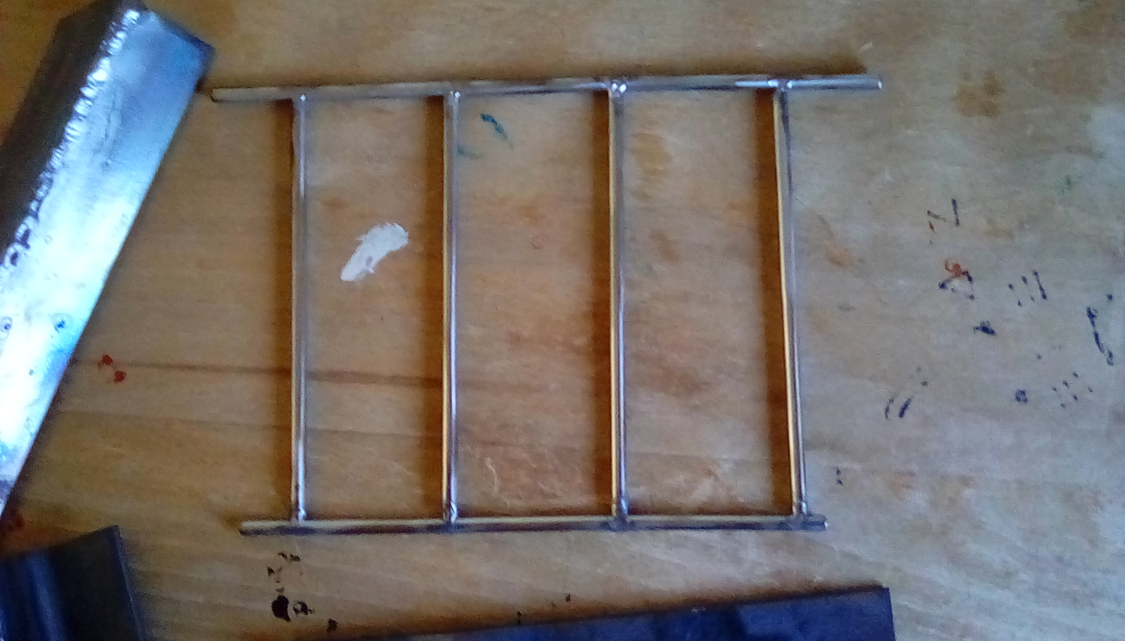

what's the best tungsten's for welding 5mm stainless rod without filler rod i've got good result's with grey's but i'm wondering if any others would be better?

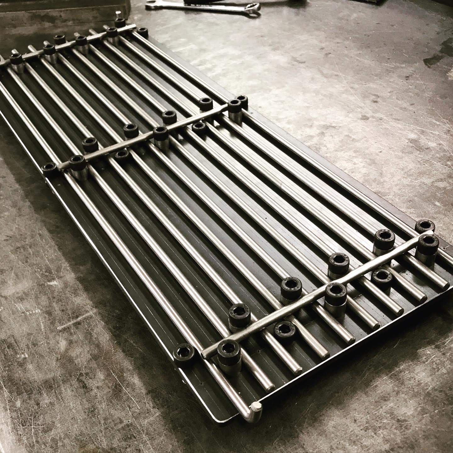

As long as it stays sharp and you don't put too much amperage through it for it's size, it doesn't really matter, it's not going to affect the weld quality in the slightest.That's the sort of jig i'm thinking! is that hf start?
