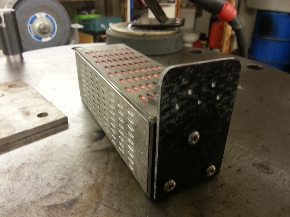

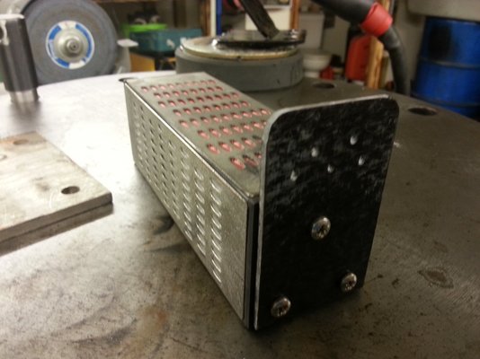

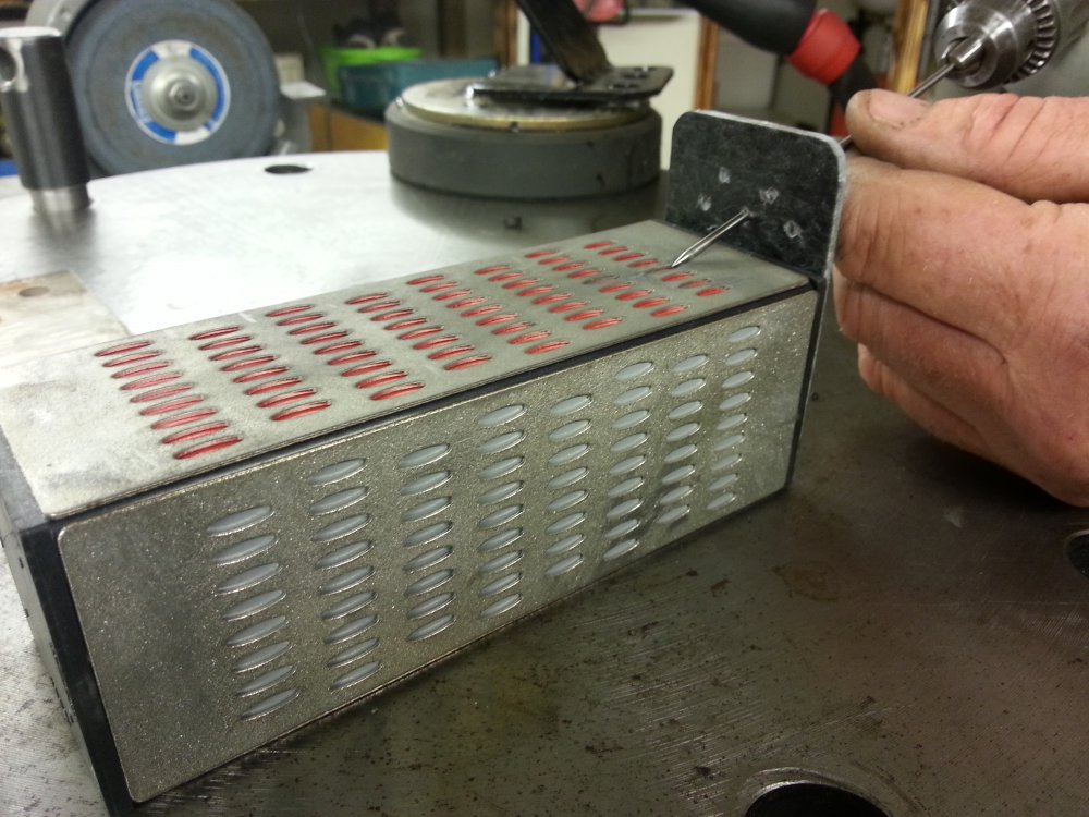

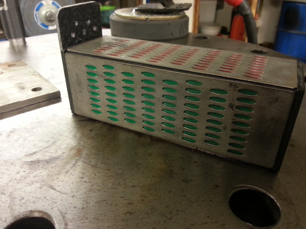

..Take a diamond sharpener bought cheaply at loads of places and screw a piece of fibreglass on the end,a few holes angled down used as a steady only and put the tungsten into a high speed drill and spend about 30 seconds very lightly pressing the tip onto the diamond surface resulting in a super smooth even sharp tip.The arc now exits from right at the tip with zero profile arcing.Dont laugh before you try you,ll be very surprised
