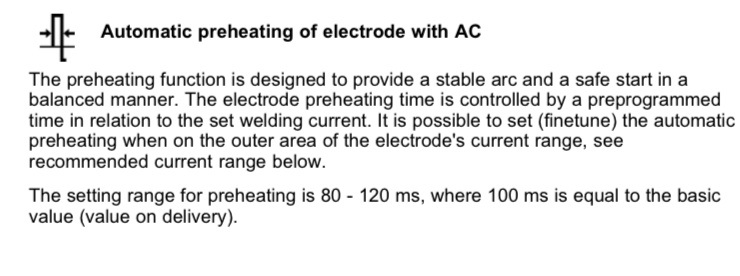

I was wondering if anyone knows what this is for, as I haven’t seen this on other sets I’ve used?
Yes it’s typically related to tungsten diameter and the actual starting values and as it’s only a matter of milliseconds it’s usually automatically controlledAh right, learn something new every day.
So this is an automatic background feature in newer sets?
