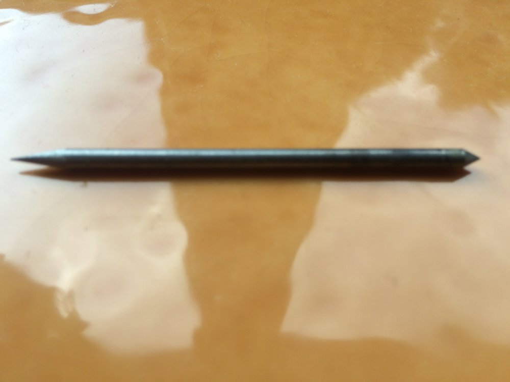

Hi guys I am using the hudmut tungsten grinder and I am only able to get a fairly stumpy point to the tungsten. Raising and lowering the diamond wheel will not effect the grinding angle within the hudmut. What do you guys think to the point length ?
I have the same tungsten grinder and it works perfect as long as you use it correctly take out the guide from the first hole on the left as you are looking at it replace that guide with the one for your tungsten size then grind simple there should be 5 holes for the guides each will give you a different grind angle just checked and these are the angles from left to right are 10,15,20,25 and 30 degrees

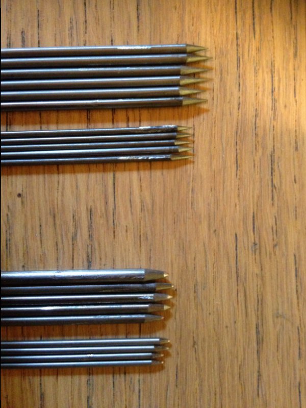

Remember the angle you prep the electrode changes the width of the arc. Those would really only be of any use if you were doing a thickish square edged butt joint where you want a wider arc transferred across both pieces. You saw how I prepped mine on that soft wheel. That's what you should be looking at for most general tig work 3mm and below. 2-3 times the diameter should be the point length. Fillet welding those preps would be pretty useless. The mud huts I've never used.
Top ones are my pre preped DC tungstens which have slightly varying angles depending on joint.

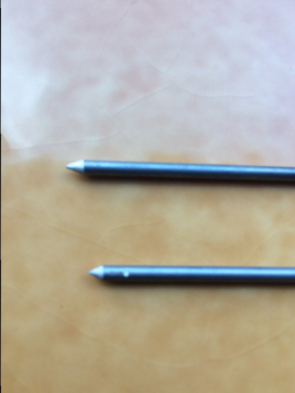

Bottom ones are my AC tungstens which I grind at 2 angles. The reason I do that is the narrower top angle always produces the perfect shiny ball. Again the top angle I vary in size depending on ball size I want to achieve, depending on joint.

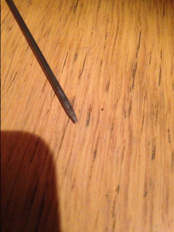

Last pic shows the perfect little shiny ball achieved after use with AC. I rarely change the balance at all from 30% DCEP so it's the electrode prep that I rely on getting the right finish.

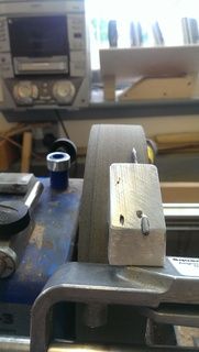

i'm pretty new to this , but i have been using a tormek wet grinder for doing mine , made up a jig to hold the electrode ,1.6 and 2.4 , and i use a cordless drill to turn the electrode slowly whilst using the whole face of the wheel ! don't know if it's the conventional way but it seems to work for me !
will try and put a pic up of my system soon if anyone wants a look !
