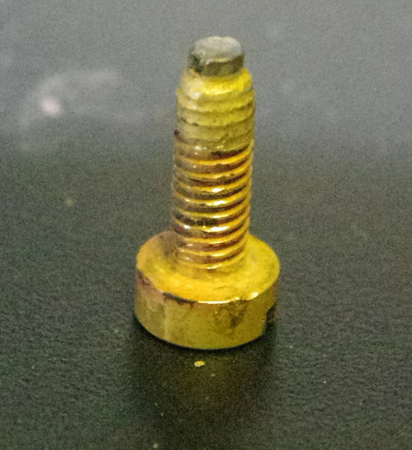

trying to make some contacts for something. They are a pill of tungsten
soldered to a brass bolt.
It solders easy enough. Using Silver-Flo55.
The tungsten chipped really badly cutting the tungsten down. I was cutting with
an angle grinder with a diamond disc and wasn't at all surprised when it chipped.
The tunsgten is probably a red one.
Would a different tig tungsten make better contacts?
Do the different tungstens chip worse than each other, or was it just a disc for cutting bricks is ****?
I have used chalk dust and isopropanol as solder mask before, quite successefully. I tried the same
with the brass bolt and to my horror as the tungsten tinned the silver shot along the first few threads.
Anyone got any ideas on solder mask ?
