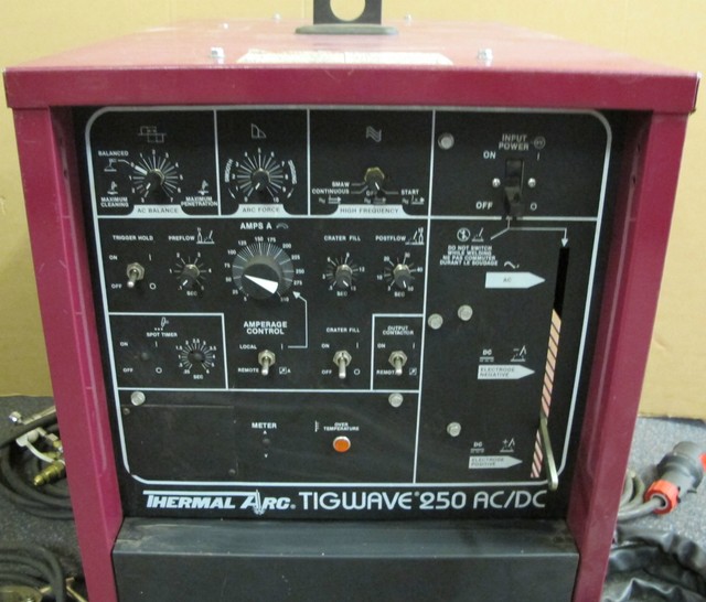

As said, a pic*/more detailed info would help but to get the obvious one out of the way check the polarity; torch wants to be negative (DCEN). DCEP melts the tungsten as around 2/3 of the arcs heat occurs at the positive electrode
Just looked at front of welder and the idiot proof pictures say torch +ve return -ve
From your previous posts (be a LOT easier if you included relevant info when asking for help) it's a Thermal Arc 250 AC/DC? What is the EXACT model as they had several 250A TIGs, some of them have multiple sockets on the front and others have a polarity switch* instead. Swapping the leads around if it has a polarity switch ain't the best way to fix things but the short version is that it's either labelled wrong, connected up wrong or there's a switch in the wrong position as (with a couple of specialised exceptions) the torch NEEDS to be negative for DC TIG. As an aside incorrect polarity will also mess with the way AC balance settings work when welding on ACJust looked at front of welder and the idiot proof pictures say torch +ve return -ve
