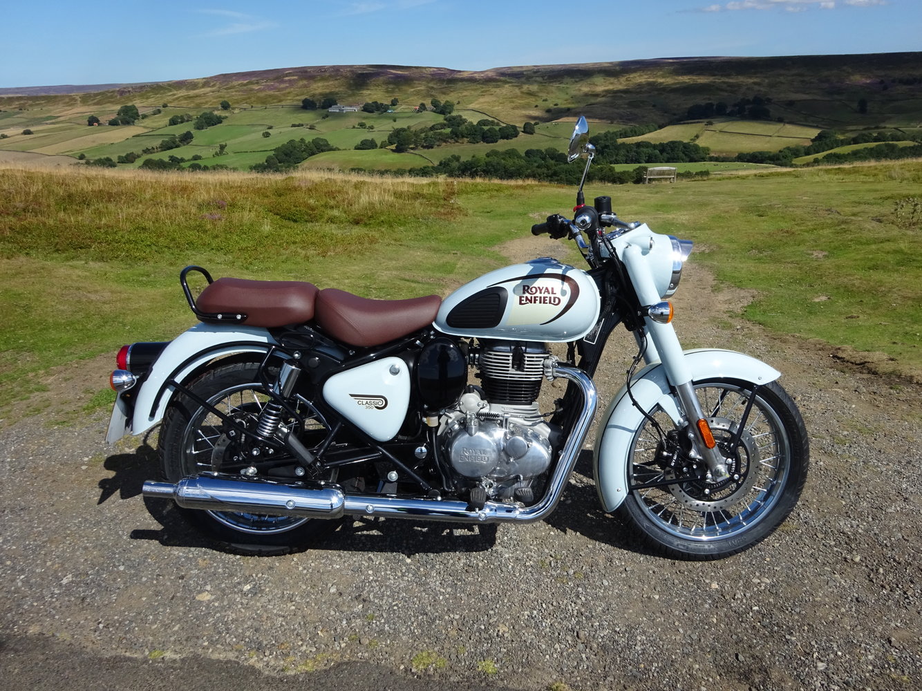

bought myself a little RE classic 350 and I'm going to make my own rack/backrest for as I can't find a suitable one. they're all to low.
the picture isn't my bike but getting the same colour etc. you'll notice the fixing.
I've got some 16 mm solid bars so I'll get them machined to fit inside the tubing and dress the bar to suit.

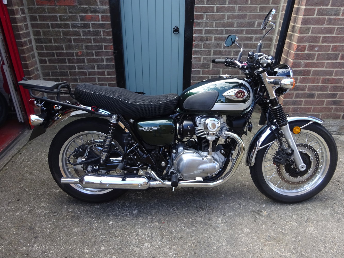

recently I bought a W800 and I'm not really keen on so I'll sell it on.
