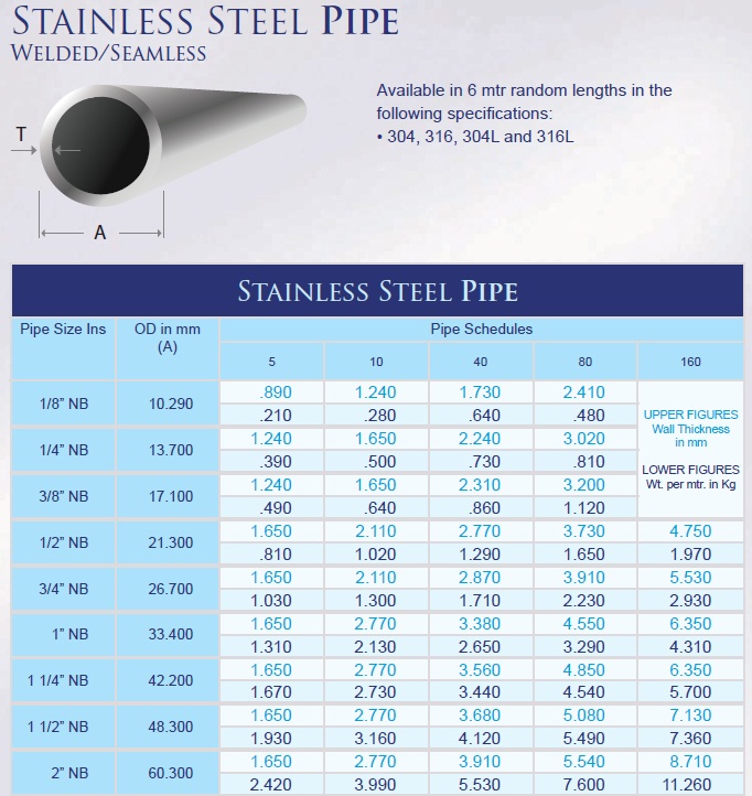

Is there a table somewhere which will give me some idea of the strength / rigidity of various tube sections - e.g. For the sake of argument, if I have a 2 metre length of 304 ERW stainless steel tube, 35mm diameter and with a wall thickness of 2mm, how much weight can I hang in the middle of it before it will collapse? I have been asked to make a monkey bar for a gym and I need to decide what tube to source for it. Don’t worry though, once I can find some basic data I will add plenty on top (double it maybe) to ensure it is strong enough!
What I am looking for sounds like fairly basic data but I am struggling to find it - perhaps because I am not sure what 'terms' to search for?
