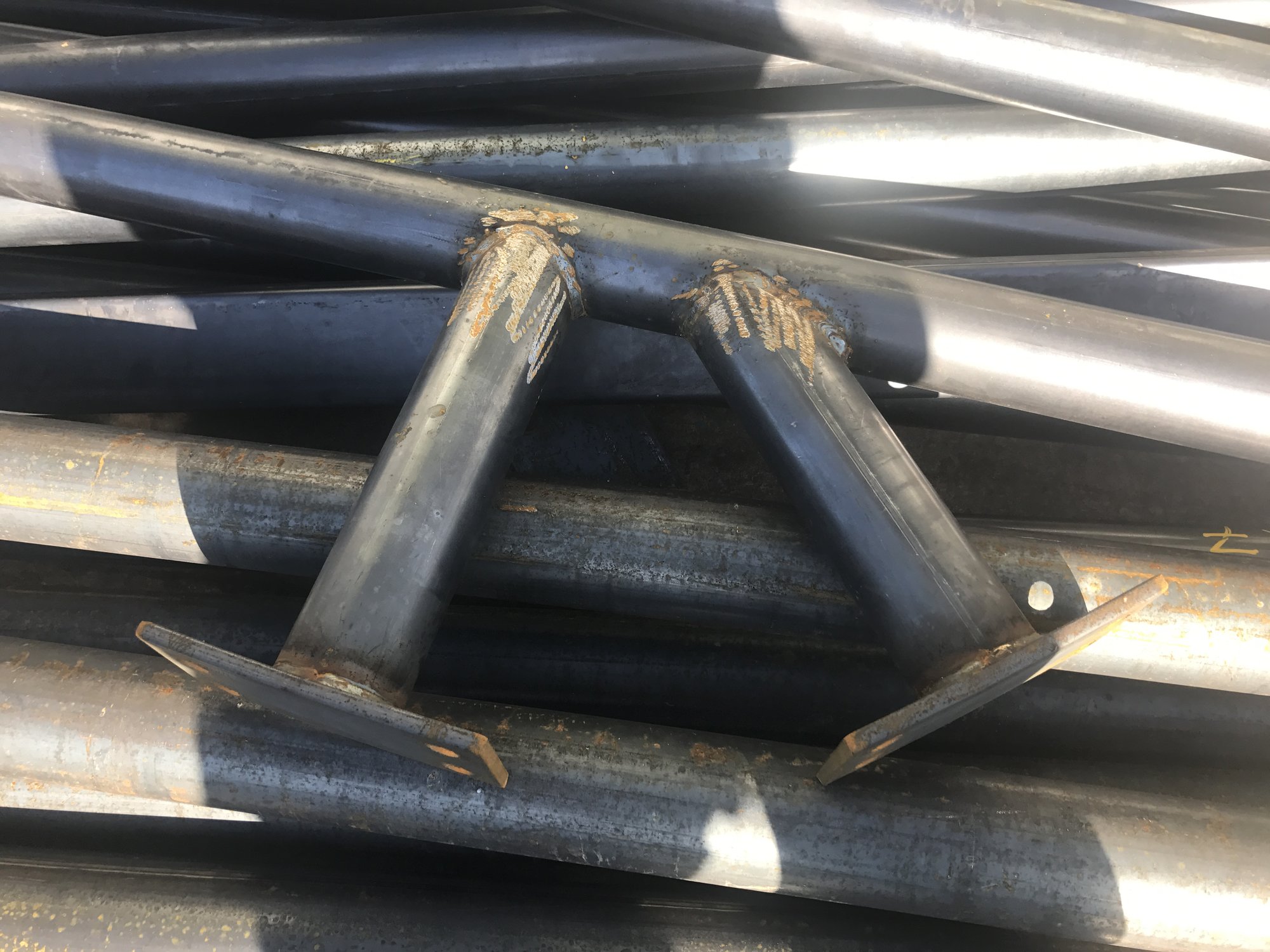

I have a job on that needs 76 o/d chs notching to join to another 76 o/d chs at an angle.
I wanted to give the fabricator some paper templates so they can mark the ends and plasma cut them.
Found this bit of software where you input sizes / angles etc and it creates a pdf to print off and wrap around the end of the tube,
I shall be up the shop on monday so will let you know then if it works for real
Heres a link to the program
http://dogfeatherdesign.com/ttn_js/
