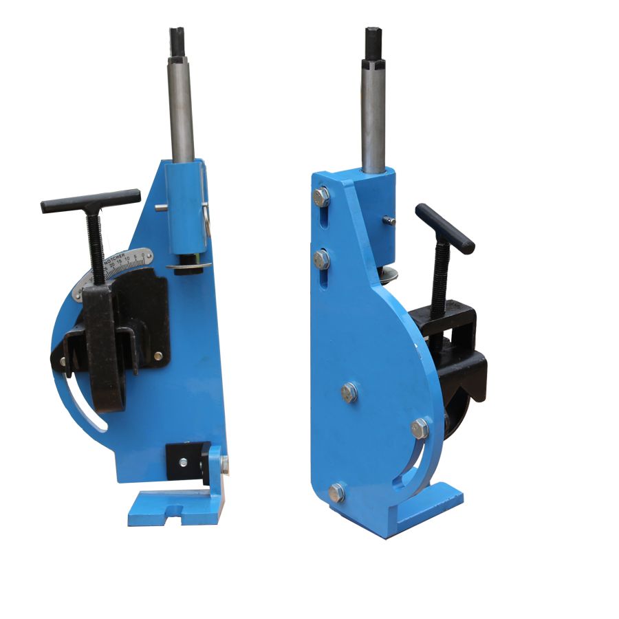

G Gizmo.Y Member Messages 848 Mar 30, 2019 #1 Afternoon Gents. has anyone a solution to replacing the bearings in the cheap ebay notchers? They look like just a copper insert?
wyn Member Messages 3,792 Location Cardiff Mar 30, 2019 #2 I have used 20mm id needle roller bearings on that type of notcher. The block needs to be machined out to get them to fit.
