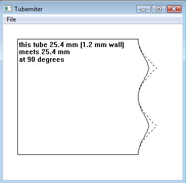

Hi All
I posted this as an answer in another thread although I thought it worthy of its own space. It has come in handy many times.
Go to http://www.ozhpv.org.au/shed/tubemiter.htm and download the file "tubemiter.exe by Giles Puckett". This is a very small file 124KB and when executed does not load or install anything on to your PC.
Run the file click "File" then "settings" put in your tube size and angles etc and a diagram is produced you can print, cut out, wrap around your tube mark and cut. very simple and accurate.
Hope this helps.
PS here is an example of the result.
Hi All
Hope this helps.
