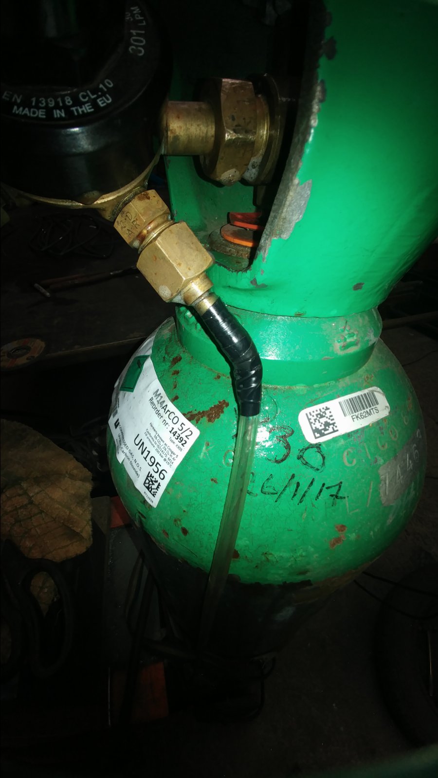

chunkolini celebrity artiste Messages 9,615 Location Swansea Feb 17, 2017 #1 What size and type of tube from regulator to welder? And where do i get it from? Also what fittings? Just littke little jubilee clips? I have a pinhole leak. Cheers.

Tom Orrow L Member Messages 2,819 Location Shropshire, UK Feb 17, 2017 #3 You just need some standard braided argon hose with a 3/8BSP Nut & Tail + whatever fitting your welder uses to connect to the machine.

pondy Member Messages 1,627 Location chedburgh, suffolk. uk Feb 17, 2017 #4 stick this number in ebay 291681629949 any good?
chunkolini celebrity artiste Messages 9,615 Location Swansea Feb 17, 2017 #5 Looks like something I can pick up locally and get some little jubilee clips.
Robotstar5 Casanunda Staff member Messages 23,397 Location Birmingham Feb 17, 2017 #7 As above, you're better off using O clips - link to Ebay example
