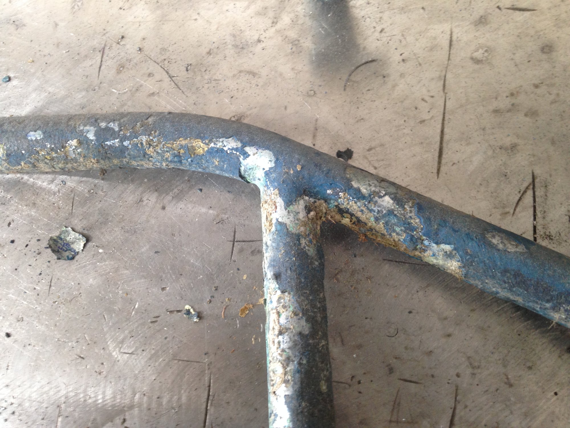

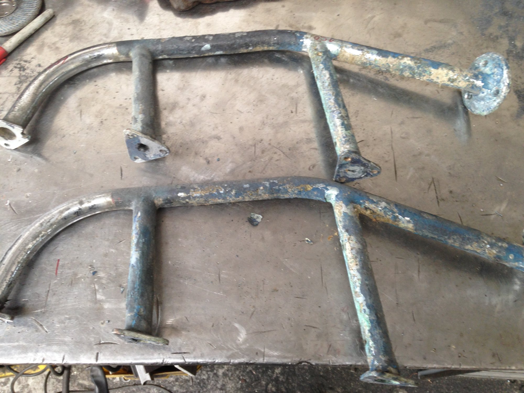

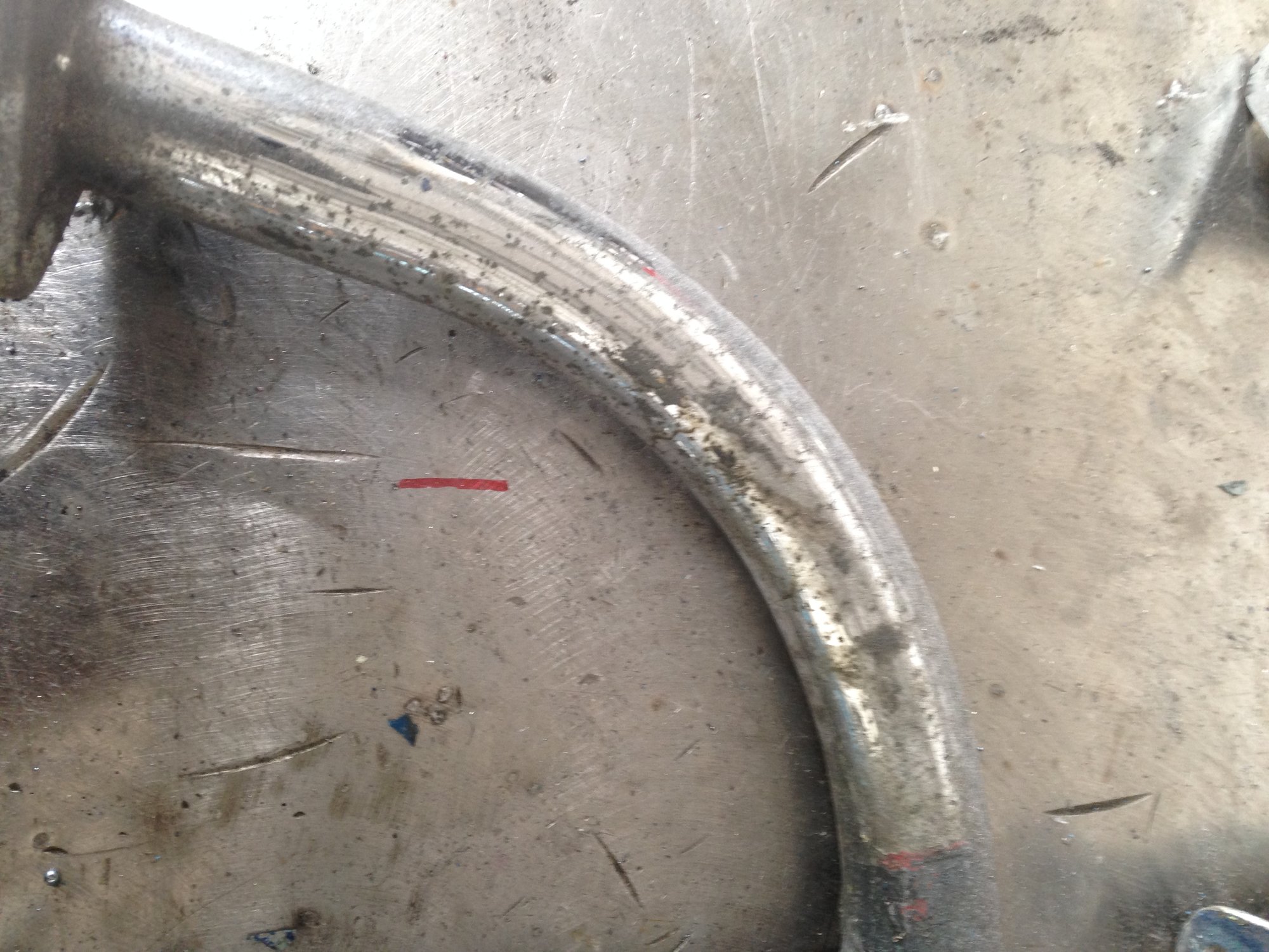

That was my first thought, but what ever you use check the bend radius it probably wont be the same, so will need to make some kind of jig / template to achieve the same shape / outcome with a slightly different radius.Maybe invest in a conduit bender, it should be able to handle 25mm x 1.5mm.
